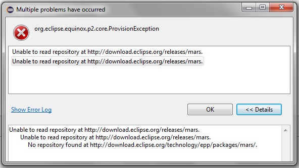

Am 08.07.2015 um 13:05 schrieb David Rabely:
> Hello Eike,
> I also installed "Eclipse Modeling Tools" 64 bit. and I don't have access to update site mars.
> From my Error log:
> org.eclipse.equinox.p2.core.ProvisionException: Unable to read repository at http://download.eclipse.org/releases/mars.
> at org.eclipse.equinox.internal.p2.metadata.repository.CompositeMetadataRepository.addChild(CompositeMetadataRepository.java:185)
> at org.eclipse.equinox.internal.p2.metadata.repository.CompositeMetadataRepository.<init>(CompositeMetadataRepository.java:106)
> at org.eclipse.equinox.internal.p2.metadata.repository.CompositeMetadataRepositoryFactory.load(CompositeMetadataRepositoryFactory.java:122)
> at org.eclipse.ui.progress.DeferredTreeContentManager$1.run(DeferredTreeContentManager.java:232)
> at org.eclipse.core.internal.jobs.Worker.run(Worker.java:55)
> Caused by: org.eclipse.equinox.p2.core.ProvisionException: No repository found at http://download.eclipse.org/technology/epp/packages/mars/.
> at org.eclipse.equinox.internal.p2.repository.helpers.AbstractRepositoryManager.fail(AbstractRepositoryManager.java:395)
> at sun.reflect.NativeMethodAccessorImpl.invoke(Unknown Source)
> at sun.reflect.DelegatingMethodAccessorImpl.invoke(Unknown Source)
> Notify me if you want all the stack trace.
I'm not sure if it's related but for some users who used Mars milestone builds it helped to delete the
${user.home}/.eclipse/org.eclipse.oomph.p2/cache folder. Maybe you try that?
Cheers
/Eike
