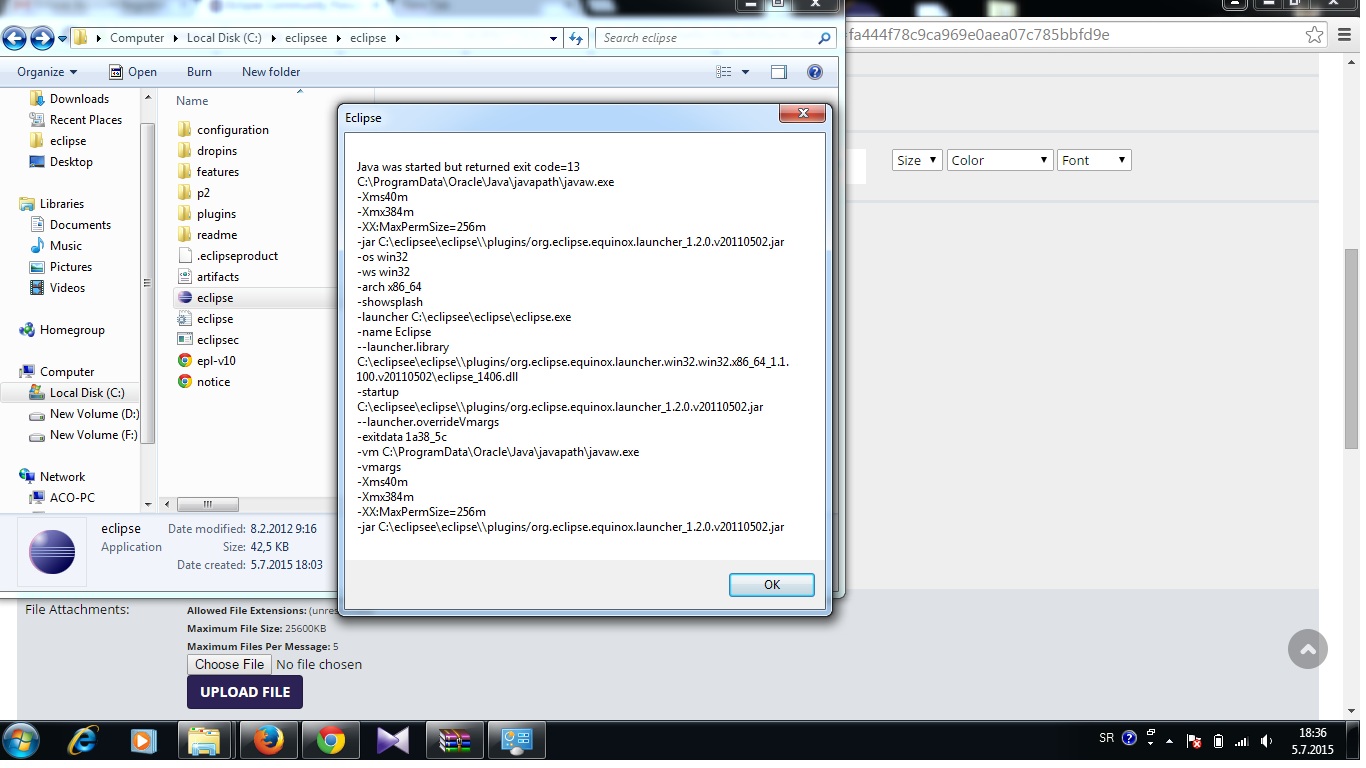

This is show when i run
Eclipse

Am 06.07.2015 um 13:24 schrieb aleksandar davidovic:
> Eclipse
That might be a problem with your system Java VM. The new Eclipse Installer would configure that automatically for you:
http://www.eclipse.org/downloads/installer.php
Cheers
/Eike
> Eclipse
Likely the bittedness of your Eclipse doesn't match that of the JRE
you're trying to run it on.
