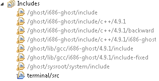

I've tried to configure the project to use a "Cross compiler" toolchain and set the "Command to get compiler specs" under "C/C++ General -> Preprocessor Include... -> Providers -> CDT Cross GCC Built-in Compiler Settings" to use my compiler (namely i686-ghost-g++). This results in the include paths in my attachment being determined.
Well, this is obviously correct for the compiler but does not work on Windows, because the compiler does not emit the "C:/cygwin" part of the path. Is there a way to define a prefix for these?
