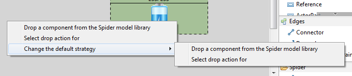

Re: CSS Canonical does not work in SysML [message #1701068 is a reply to message #1700354] Thu, 09 July 2015 03:46 Go to previous messageGo to next message
Hi Christian,
When I register a new D&D strategy (disable the registration of the new EditPolicyProviders), the popup menu is like the following :
index.php/fa/22448/0/
There are two dnd strategies in this case:
- the new one I've just created "Drop the component from the Spider Library"
- and "Selection drop action for"

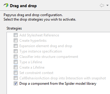

But in fact, "Selection drop action for" is not listed in the Preferences\Papyrus\Drag&Drop. This is a default DnD strategy, which is created "on the fly" in the class DropEditPolicy, which is then instantiated by DropEditPolicyProvider.
That means, evens I deselect all d&d strategies but my own one (cf the figure below), the popup menu is always displayed when user drag&drop a component from model lib.
index.php/fa/22449/0/
Do you have any idea?

Re: CSS Canonical does not work in SysML [message #1701118 is a reply to message #1701068] Thu, 09 July 2015 09:01 Go to previous message
Hi, PTL,
That is a bug. Would you mind raising it in bugzilla?
https://bugs.eclipse.org/bugs/enter_bug.cgi?form_name=enter_bug&product=Papyrus&version=1.1.0
Thanks!
Christian
