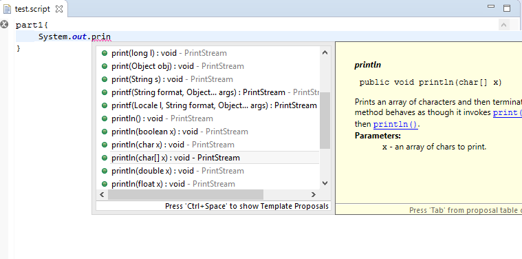

Re: Embedding DSL in Java [message #1701270 is a reply to message #1701095] Fri, 10 July 2015 07:47 Go to previous messageGo to next message
I want to have auto completion in DSL editor when I write java code block. Something like this photo.
  • Attachment: 1.png
    (Size: 23.94KB, Downloaded 114 times)
Re: Embedding DSL in Java [message #1701271 is a reply to message #1701270] Fri, 10 July 2015 07:48 Go to previous messageGo to next message
this works out of the box ?!?
Re: Embedding DSL in Java [message #1701303 is a reply to message #1701271] Fri, 10 July 2015 13:32 Go to previous messageGo to next message
I made it in paint Smile but I want to develop somnething like this.
Re: Embedding DSL in Java [message #1701308 is a reply to message #1701303] Fri, 10 July 2015 14:40 Go to previous message
Have a look at the domainmodel example
