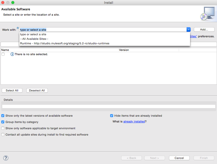

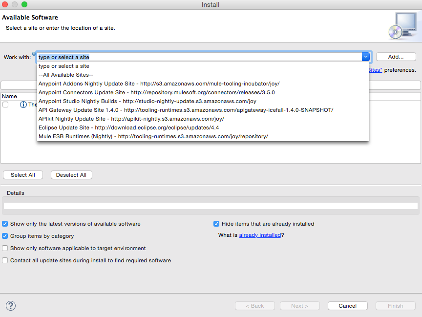

I would like to ask two question:
1 ) Why RRCPT not add the update sites url of my Eclipse when running it through RRCPT.
I have checked it by running the APP without RRCPT and the urls are ok (by default), but not when running it with RRCPT.
Is it a bug or am I missing something? I have attached a screenshot of both situations in order to clarify.
2) Is there a problem when a make a test which restart the AUT? Basically, when I run this kind of test, the AUT does work similar as the first run.
Agustin Celentano
Re: RRCPT does not add the URL (update sites) when run the AUT. [message #1700363 is a reply to message #1699654] Thu, 02 July 2015 03:38 Go to previous messageGo to next message
Hi Agustin,
1) Information about update site links is stored in Eclipse workspace.
Since AUT workspace differs from a workspace which you use when you run your Eclipse standalone, you see two different "pictures".
2) There shouldn't be any problems with AUT restarts, could you please give more details?
Kins regards,
Ulyana.
