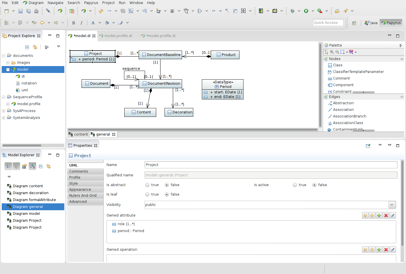

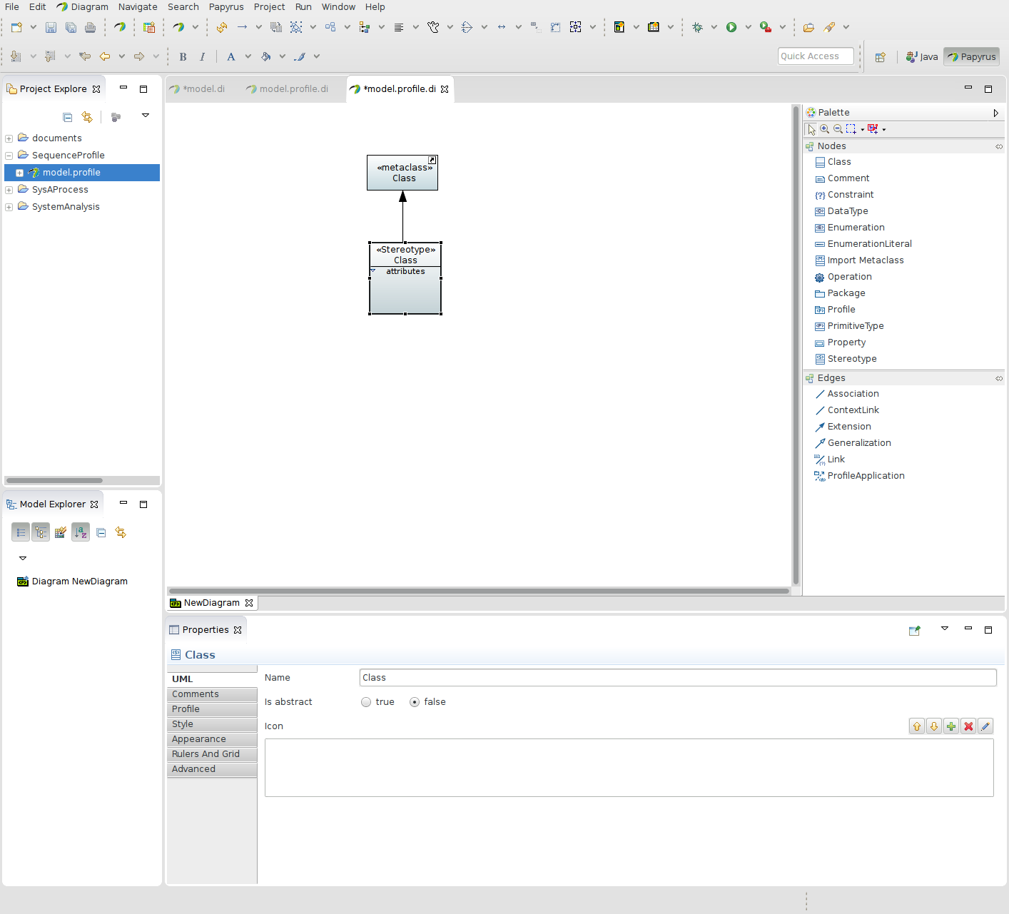

I thought I did it before: in defining a profile adding an attribute to a stereotype in order to become a tag in a model using that stereorype.
But looking at the properties window of a stereotype, I was expecting "Owned attribute" field, like with classes. It's not there, at least in my Luna installation 4.4.2 with Papyrus 1.0.2.
For illustration I attached two screenshots as they appear on my screen. One with the profile diagram selecting a stereotype showing its properties window, the other for a class. The first is missing the "Owned attribute" field as is exposed on the second one.
What did I miss?
[Updated on: Thu, 18 June 2015 00:34] by Moderator
Re: for Stereotypes missing "Owned attribute" in properties. [message #1698819 is a reply to message #1698808] Thu, 18 June 2015 03:30 Go to previous messageGo to next message
You need to look in the "Profile" tab, apply the desired stereotype there (if not done yet) and expand the stereotype you've applied.
There you will find all tagged values.
Re: for Stereotypes missing "Owned attribute" in properties. [message #1698840 is a reply to message #1698819] Thu, 18 June 2015 06:53 Go to previous messageGo to next message
Owned Attributes are not displayed in the properites view for Stereotypes. You can see the owned attributes either in the Model Explorer, or in the Diagram directly (In the "Attributes" compartment of the Stereotype)
Camille
[Updated on: Thu, 18 June 2015 06:53] by Moderator
Re: for Stereotypes missing "Owned attribute" in properties. [message #1698922 is a reply to message #1698819] Thu, 18 June 2015 17:14 Go to previous messageGo to next message
Thank you, Johan
what I like to do is creating a profile that defines tags. I need to add an attribute that will become a tag ones my created profile is applied to some model.
It is not about using a profile an looking at tags.
Rolf
Re: for Stereotypes missing "Owned attribute" in properties. [message #1698926 is a reply to message #1698840] Thu, 18 June 2015 17:45 Go to previous message
Yes, thank you Camille
that worked (first time I used the browser to add an element).
This way I could reach my aim to have project specific tag/values at some elements.
Rolf
