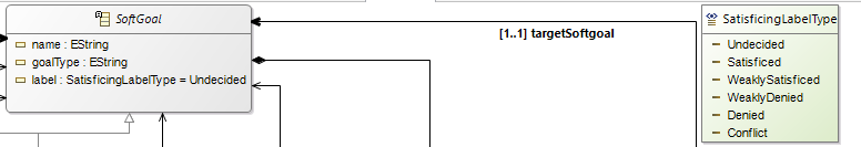

I have a question on a conditional style.
Like the following image, "Softgoal" has a "label:SatisficingLabelType" which is an Enum type containing "Undecided", "Satisficed", and etc. I want to show node style depending on the label value of a Softgoal node. In a conditional style, how shoud I write a query depending on the value of the label? I tried to use [self.label.toString.matches('Satisficed')=true/], but it does not work.
Could someone help me?
Thank you so much.
Best Regards,
Eunjung Park

I could figure out.
I should have used [self.label.toString().matches('Satisficed')=true/].

As explained on a previous post [1] and on the Acceleo wiki [2], you can
test an EEnum typed attribute as shown in the following Acceleo expression:
[self.label = SatisficingLabelType::Satisficed'/]
:: is the qualifier separator in Acceleo MTL.
