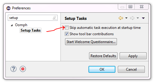

Yes, the setup tasks that exist in the user.setup file (see above)
are all executed at startup time, unless the startup task execution
is disabled in Oomph's "Setup" preferences.<br>
<br>

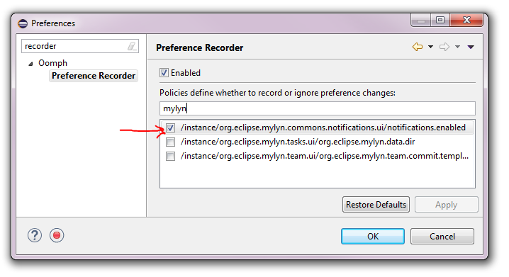

I would say correct as in "works as designed". The user can go to
Oomph's "Preference Recorder" preferences and selectively disable
the recording of specific preferences. PreferenceTasks that have
already been recorded automatically get removed at that time and
will no longer apply at startup time. Just uncheck the preference:<br>
