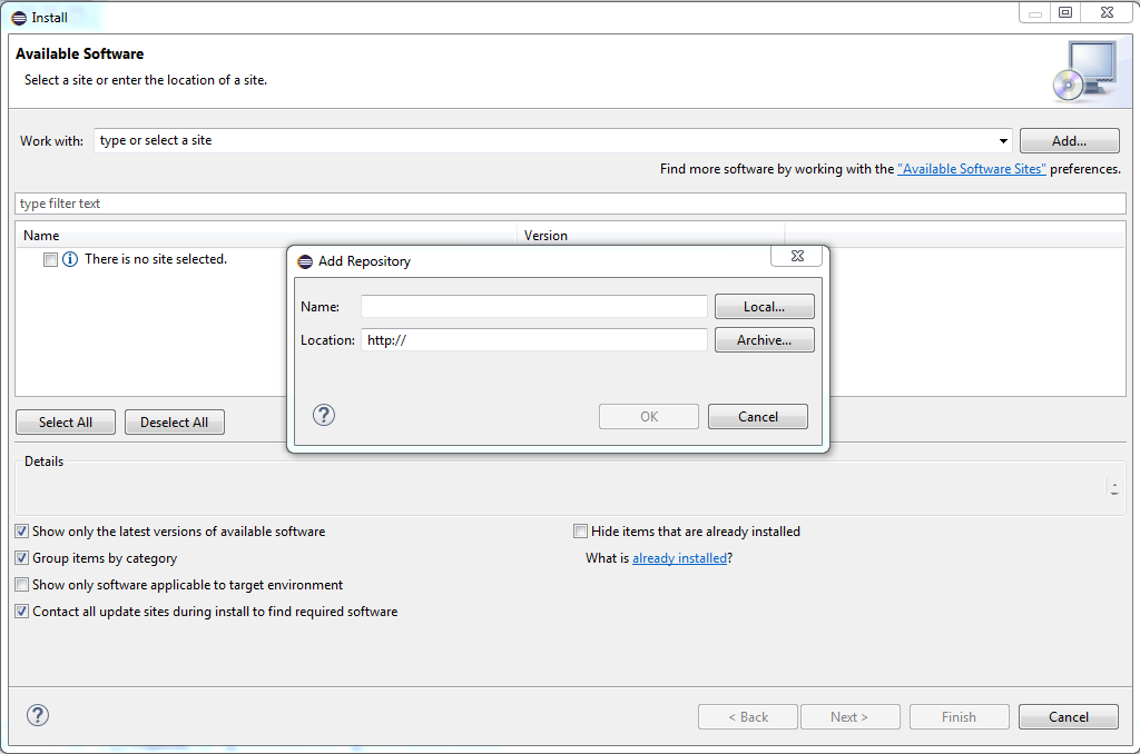

Else, once you have got Papyrus 1.0.2 Update site zip file, you have to go in Eclipse application menu "Help > Install New Software ..." and to select "Add..." button. Then, you have to indicate where the zip file is located with "Archive..." button.
