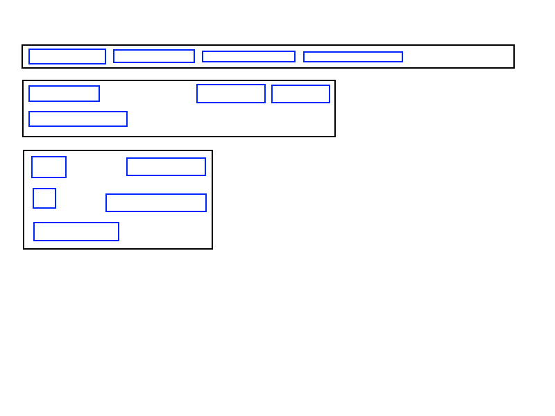

We are struggling with the alignment of toolbar managers when the tool bar wraps across multiple lines. When the toolbar fits on one line everything is aligned to the left. However when the toolbar does not fit on one line and wraps across several lines the first toolbar manager on every line is aligned to the left and grabs all excessive space making the following ones on the same line right aligned. See the attached file for an illustration.
