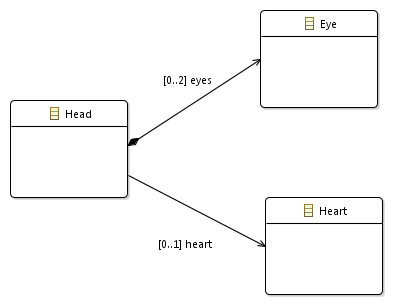

I created the simple Ecore meta-model represented in the attached file (Head containing Eye and referencing Heart). I tried to create a sample model, select the objects of this model and use the OCL consoles.
index.php/fa/22083/0/
3) Syntax self.oclAsType(ecore::EObject).eContainer() works as expected in the interactive OCL console but not in the interactive Xtext OCL console. Why ?
4) In both consoles, syntax self.head for a Eye or Heart object does not work. If I understand well question 2.4 of the FAQ, this is the syntax I should use. What did I miss ?
let anEye : Eye = ... in anEye.Head
https://bugs.eclipse.org/bugs/show_bug.cgi?id=469371 raised.

But if I use the aforementioned example, and if I select an instance of Heart or Eye in one of my sample models then play with the OCL consoles, I get the following results:
Calling self.Head on a Eye object (containment reference)
In the interactive Xtext OCL console, I get the expected result (the containing Head object)
In the interactive OCL console, I get an error: Unrecognized variable: (Head)
Calling self.Head on a Heart object (non-containment reference)
In the interactive Xtext OCL console, I get an empty result
Does it mean I can use syntax self.Head in my OCL business constraints ?
