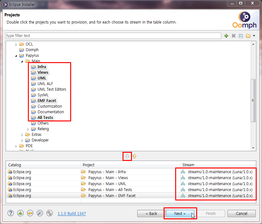

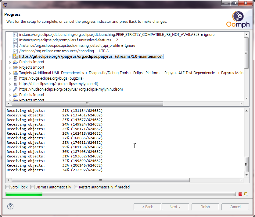

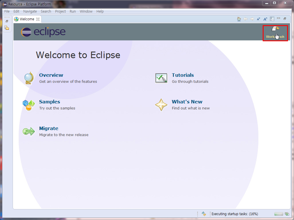

Finally I could get my Papyrus Development Environments!!
Thank you all the replies to my questions.
I'm not 100% sure that this is correct procedure, but I'll post that here to share the infos and get feedbacks if something is wrong.
Total 13 images will be provided.
1.
index.php/fa/22076/0/

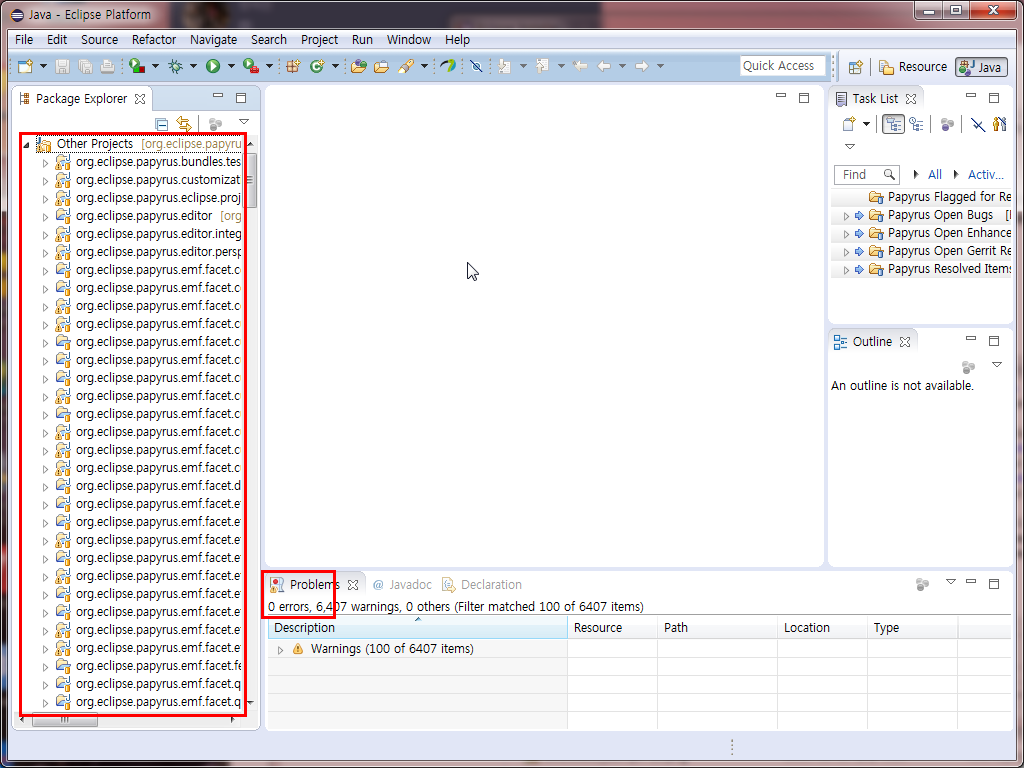

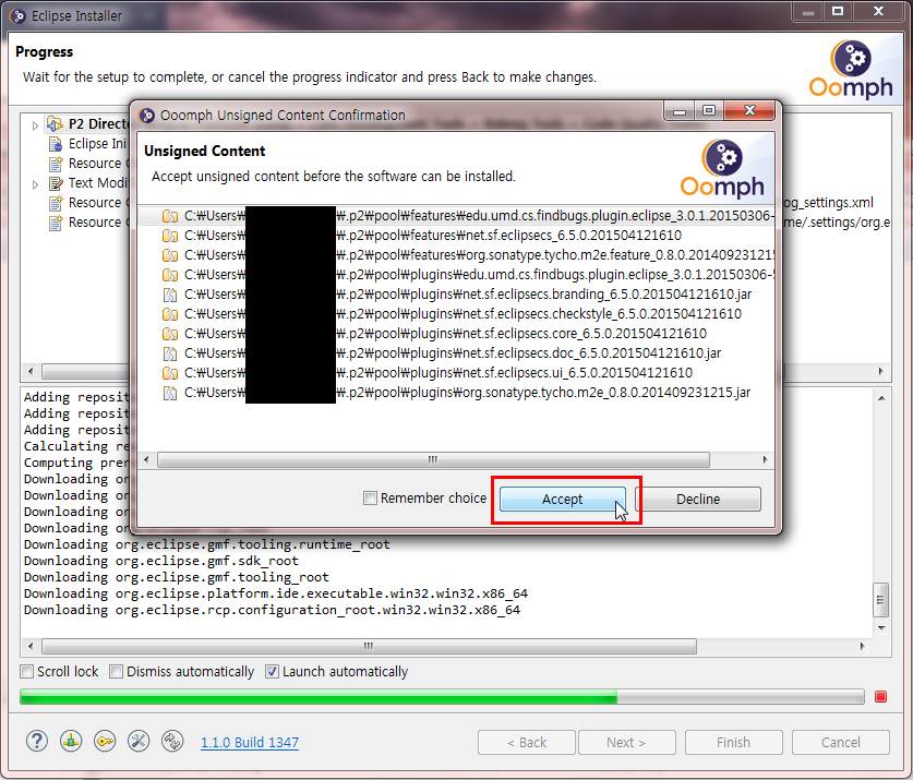

2.
index.php/fa/22061/0/

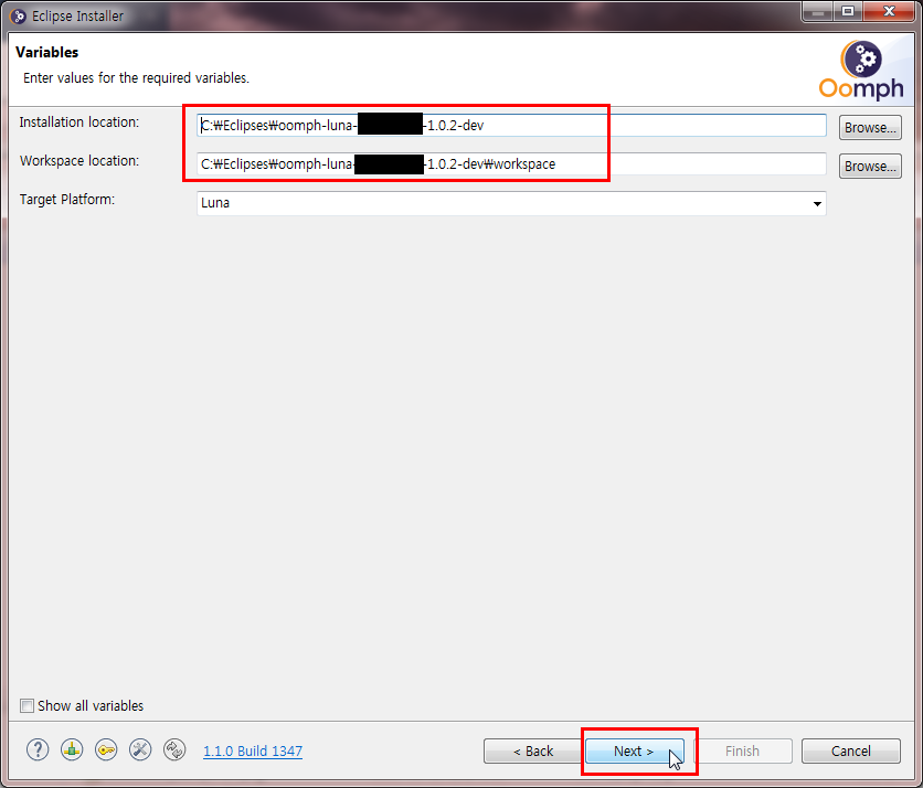

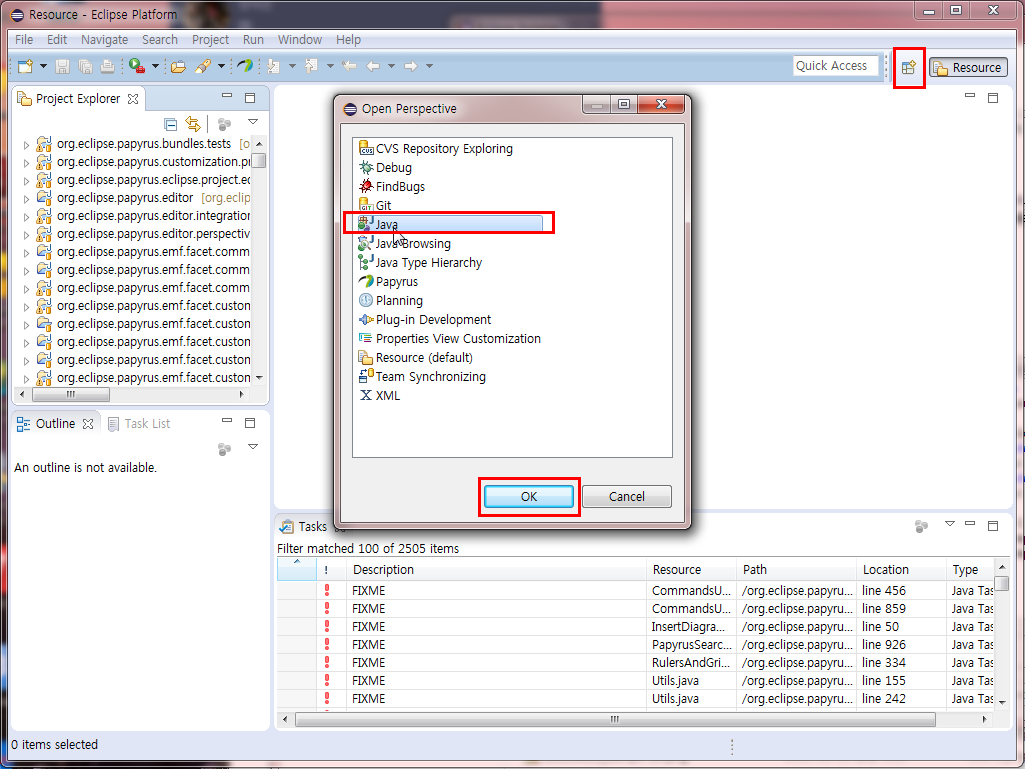

3.
index.php/fa/22073/0/

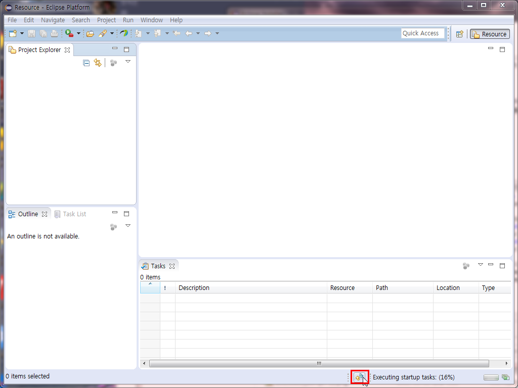

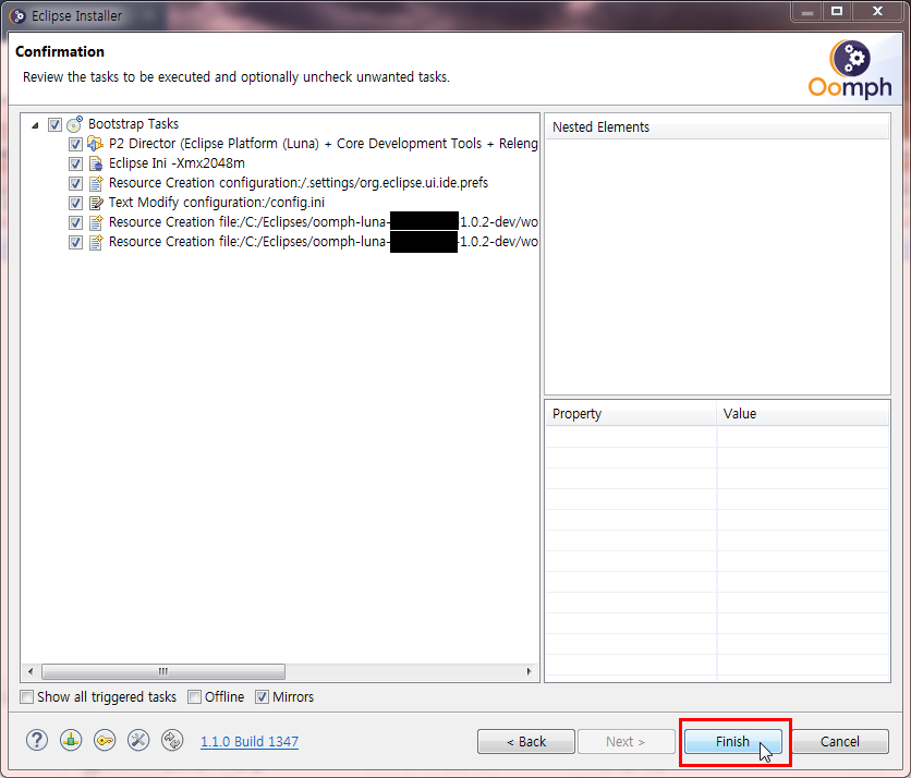

4.
index.php/fa/22074/0/

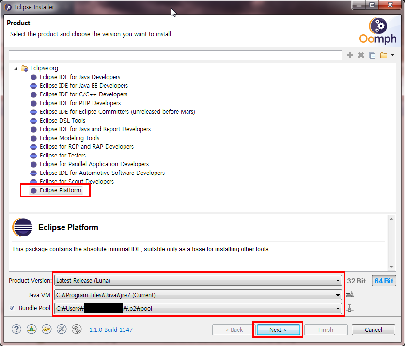

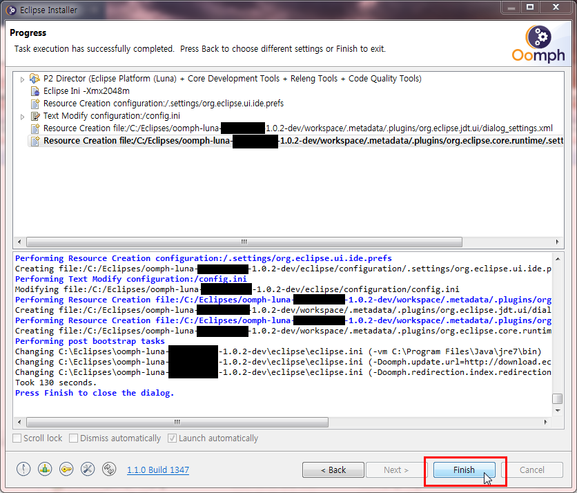

5.
index.php/fa/22075/0/

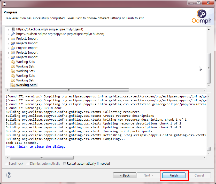

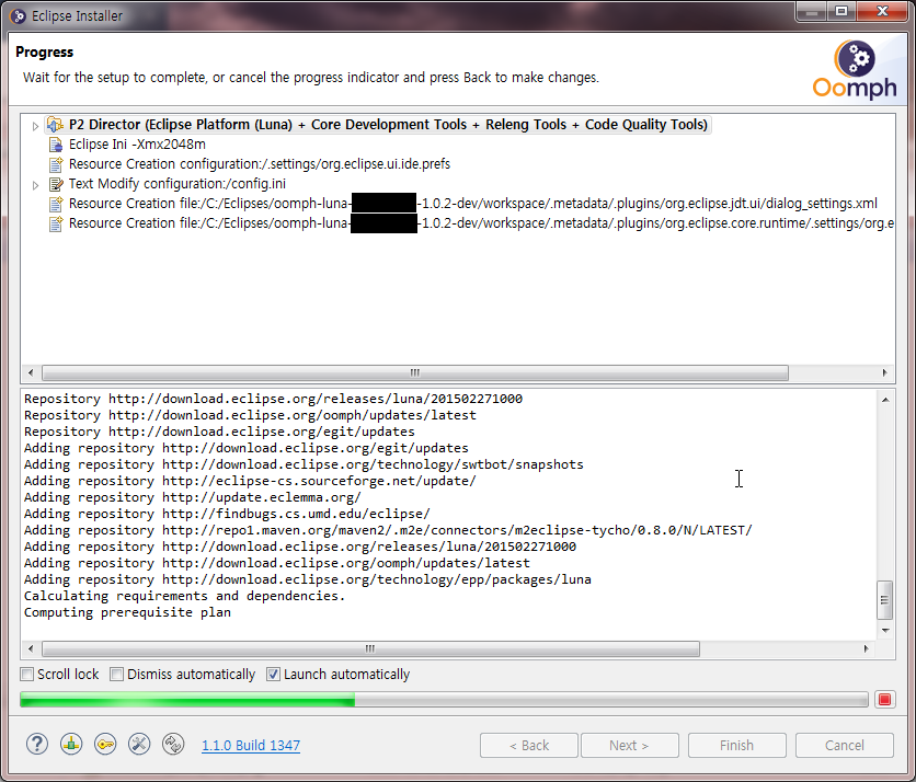

6.
index.php/fa/22077/0/
