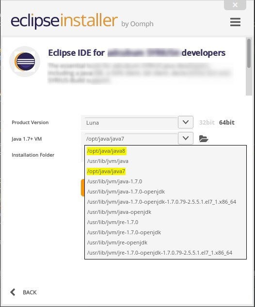

2) Is there a possibility to display the user Jvm's (.eclipse/org.eclipse.oomph.jreinfo/extra.txt) only on the simple mode installer page? (See marked elements at attached file)
I'm not sure I parse what the word "only" implies in this sentence. You
want only the user added JVMs displayed in the dropdown? Or you're
asking if you can only display the user added JVMs in the installer
page? In any case, wherever the dropdown is available, the Java Virtual
Machines dialog is available, and you can use that to make a
selection. Your selections are also remembered across all
applications, so you'll generally get what you selected the last time,
so if that's the user added one, that's what you'll get...

Sorry about my bad english, I meant that I want list only the user added jvms as selection options, without the standard system jvms.

No, it will always list all valid available JVMs.
