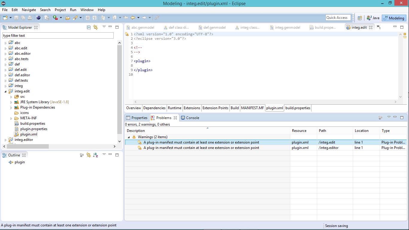

Re: How can I integrate ecore models? [message #1697646 is a reply to message #1697569] Fri, 05 June 2015 11:04 Go to previous messageGo to next message
Thank you so much.
I have another problem related to integrate models.
I make a new ecore file from existing ecore file and the two ecore files are in the same model directory (i.e. same project).
I used ecore tool which supports to make a ecore model visually.
The problem is that when I tried to generate codes, there were warning, saying that "A plug-in manifest must contain at least one extension or extension point".
Why does this problem occur and How can I solve this problem?
Thank you every time.
Eunjung Park
Re: How can I integrate ecore models? [message #1697650 is a reply to message #1697646] Fri, 05 June 2015 11:53 Go to previous messageGo to next message
Eunjung,
If you have two Ecore Models in the same project (generally avoid that),
they should have a single GenModel or they'll ovewrite each other's
changes (especially for the .edit and .editor projects).
I think the warning you're talking about is that the plugin.xml doesn't
exist, but the model should always generated a plugin.xml, so I'm not
sure why that would go wrong. Is it empty? Does it generate an empty
one if you delete it?

Re: How can I integrate ecore models? [message #1697662 is a reply to message #1697650] Fri, 05 June 2015 15:34 Go to previous message
Thanks Ed.
I could find out what is the problem.
The new echo model(M3) which refers to existing model(M1, M2) does not have its own elements, but has referenced elements from M1, M2.
I think that cause a problem.
Any way, thank you so much.
