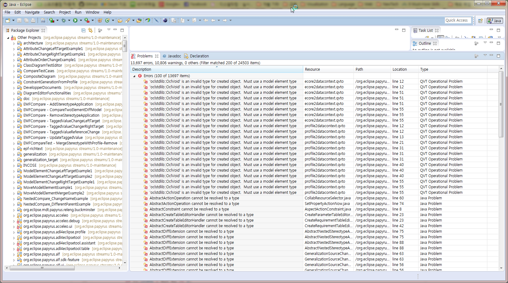

But after importing Papyrus Projects, I got build errors like below.
index.php/fa/22021/0/
Errors count is about 13,700.
I tried to start resolving these build errors by manually installing 'QVT Operational SDK'.
But after installing QVT Operational SDK, the errors count increased to over 814,000.
I installed EMF Facet SDK, MoDisco SDK, WST XML Core, XText complete SDK, OCL examples and Editors SDK, Acceleo, Acceleo Core SDK to reslove the build errors, but the errors count was even increased a little bit, not decreased.
How can I resolve all those build errors?
I try to find answers from the documents of Papyrus site, but I couldn't.
Please help me out.

Re: Error during oomph Papyrus installation. [message #1697183 is a reply to message #1697170] Tue, 02 June 2015 04:11 Go to previous message
Eclipse's incremental build is often good, but not always.
I find that a major GIT commit change often fools it.
Refresh all projects; this will often trigger rebuilds
Clean All; if the above didn't work
Restart; if the above didn't work
Your additional installs should not be needed, so you risk making
matters worse but installing a wrong. REvert o your configuration before
those installs and let Eclipse Restart and sort it all out.
Ed Willink
