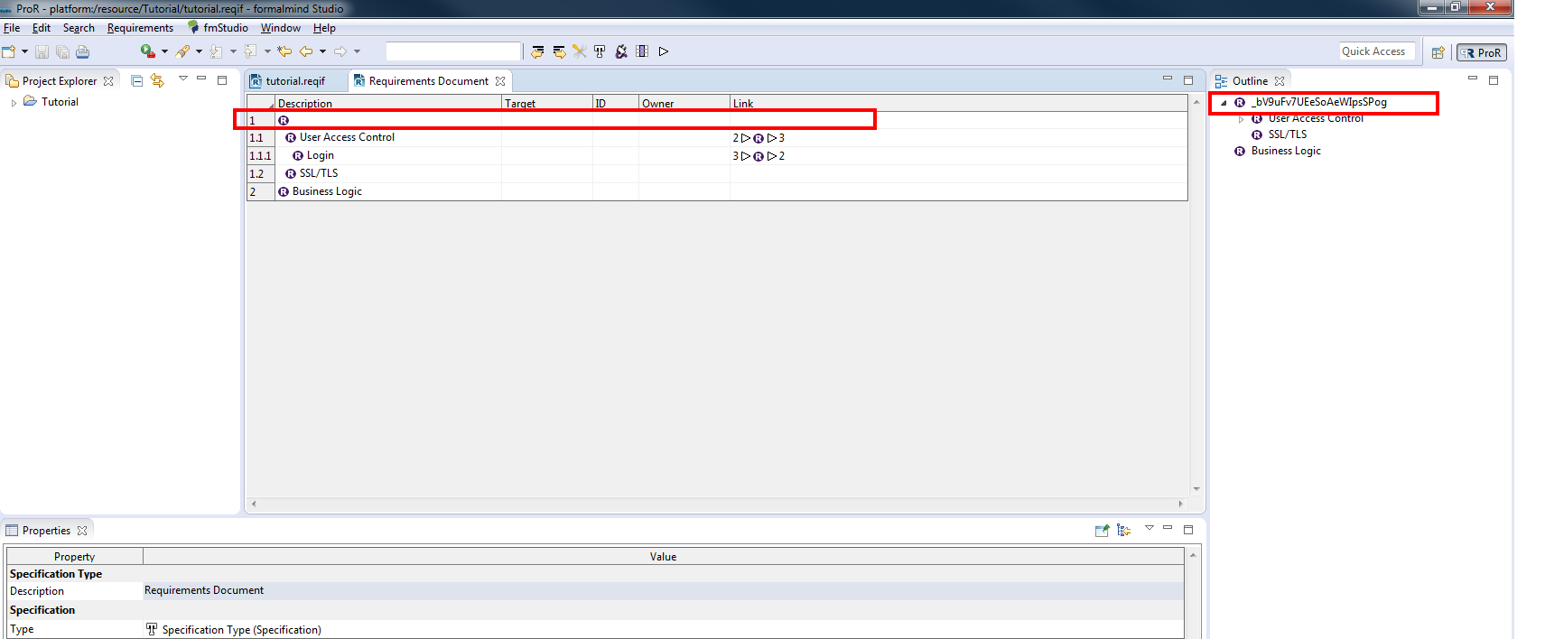

Working through the Formal Mind example exercises, I've somehow ended up with my Headline not having a Description. How can I change this?
Or, can I amend this to be a requirement type specobject? (As with Business Logic)

Hi Max,
You need to make sure that your attribute has the name that matches the Column name, i.e. ProR | Datatype Configuration | SpecTypes. The longName of the attribute must be "Description" as well to show up in that column.
I hope that helps!
Best,
