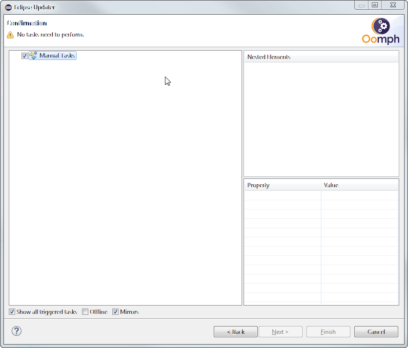

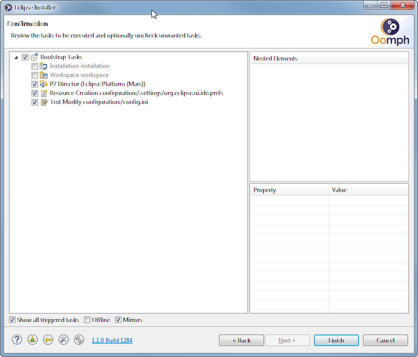

>When you perform manually on the Confirmation page, and you choose "Show
>all triggered tasks", are the tasks you're expecting really not listed
>there?
I've added three screenshots (summary of installer, toolbar of installed IDE & 'Perform setup task dialog' of installed IDE).
>> I don't understand what that has to do with my workspace and a project I should reference. Can you please explain that to me? Thanks.
>> I attached the setup log, too.
>It looks like it installed all the extra things you've specified.
>Perhaps the state of your workspace already matches all these
>preferences and there really is nothing to do. In that case you won't
>see any startup tasks performed.
The plugins are available but all my preference settings are not applied.
Dieter

>>> At home - after the installer finished and the IDE is started - the icon for the startup task appears. That's not the case when I execute the same file in my company environment.
>> there?
It certainly looks like this installation's workspace is not aware of
you having added any setup projects to it. Can use the menu you
showed to Open Workspace to open the workspace setup. You can use the
context menu to "Open in Text Editor" and paste what you see textually.
There should be at least one element at the end like this:
<stream
href="index:/org.eclipse.setup#//@projectCatalogs[name='org.eclipse']/@projects[name='oomph']/@streams[name='master']"/>
I.e., the workspace setup should reference the stream of your setup project.
