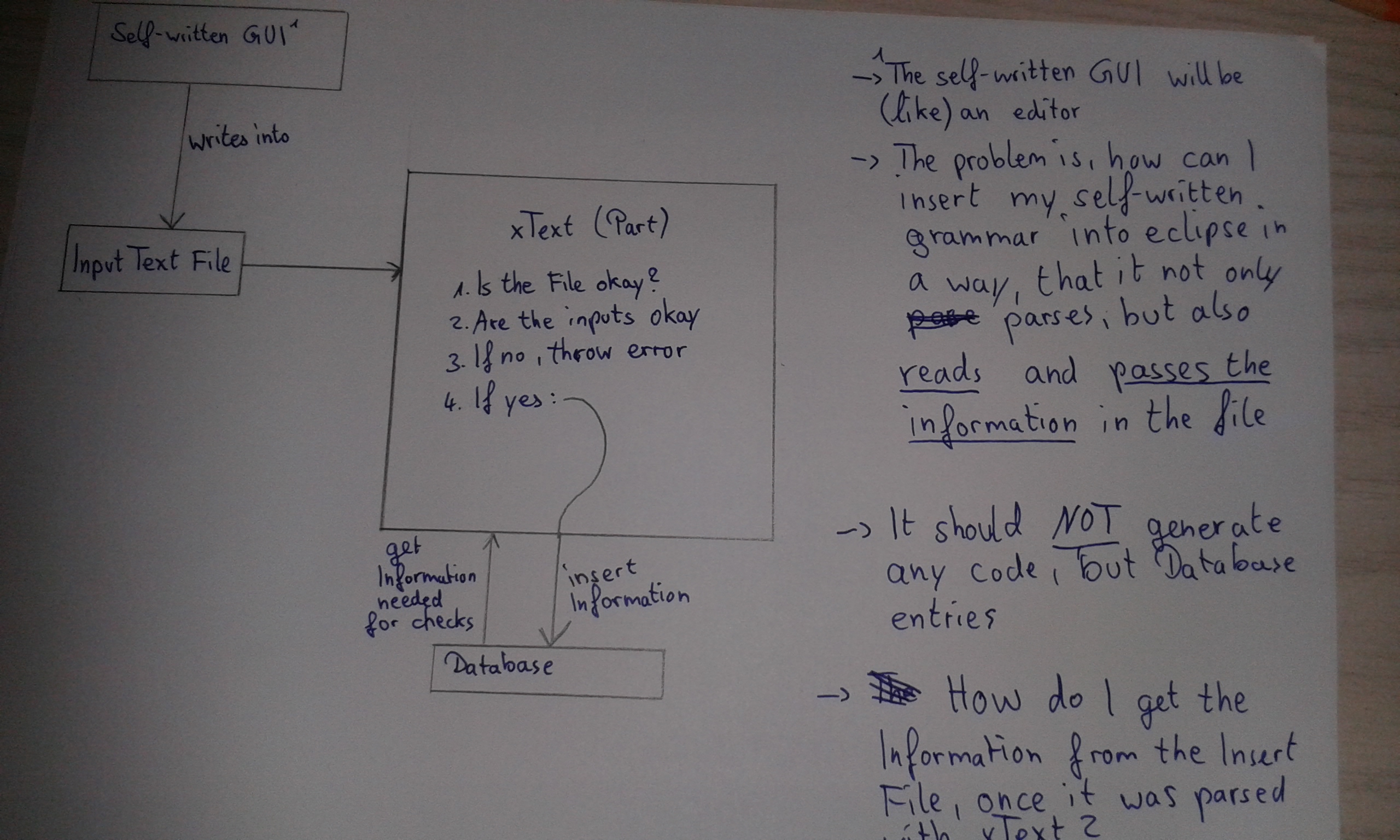

Hey
Here is a little handwritten picture, hope this helps you to better understand my problem, I don't know how to better describe it.
Maybe like this: I want it to run in a self-written Editor, passing the information (if in the correct grammar) on to a database.
[Updated on: Wed, 20 May 2015 12:21] by Moderator
Re: xText as standalone lexer, parser, interpreter? [message #1695972 is a reply to message #1695970] Wed, 20 May 2015 12:23 Go to previous messageGo to next message
then simply add the exported (runnable jar) file to the java project that holds the standalone app or even put the standalone app into yourdsl project as well
Re: xText as standalone lexer, parser, interpreter? [message #1695973 is a reply to message #1695972] Wed, 20 May 2015 12:24 Go to previous messageGo to next message
p.s. but why a self written editor and not eclipse?
Re: xText as standalone lexer, parser, interpreter? [message #1695977 is a reply to message #1695973] Wed, 20 May 2015 13:38 Go to previous messageGo to next message
p.s: you are the better swing programmer than me but you can take the following as starting point
