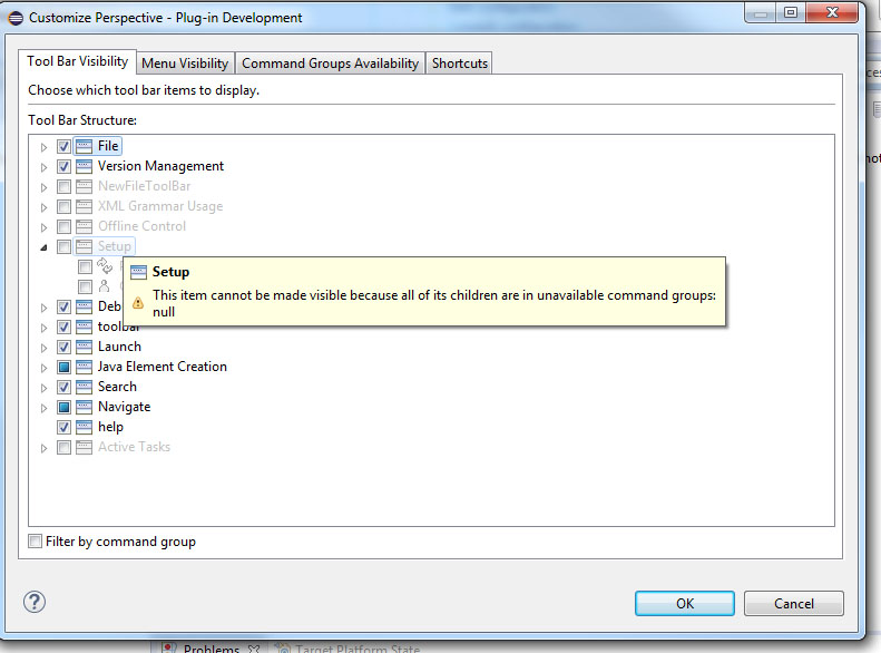

Re: Oomph was not installed in a proper way from a setup [message #1695893 is a reply to message #1695724] Wed, 20 May 2015 03:23 Go to previous messageGo to next message
My last try was to clean up my PC:
* clean up temp directory
* removed everything about Oomph
* delete all "old" profiles
* delete bundle pool and p2 cache
Since this action the startup trigger works.
But on problems stays - I added all Ooomph features to the setup file (p2 director) and I expect that the functionality is available in the materialized Eclipse IDE. However it is not. See the attached screen shot.
index.php/fa/21872/0/
  • Attachment: pref.jpg
    (Size: 121.52KB, Downloaded 361 times)

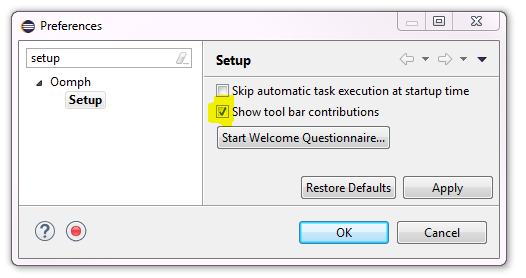

You first have to enable our toolbar contribution for all
perspectives in our preferences:<br>
<br>
<img src="https://www.eclipse.org/forums/index.php?t=getfile&amp;id=21874" alt=""><br>
<br>
Then you can probably disable it per perspective with the standard
"Customize Perspective" dialog (I haven't tested it).<br>
<br>
We could investigate alternative approaches. If you that's what
you're suggesting please submit an enhancement request against
Oomph|Setup.<br>
<br>
Cheers<br>
/Eike<br>
<br>

Re: Oomph was not installed in a proper way from a setup [message #1695909 is a reply to message #1695903] Wed, 20 May 2015 05:03 Go to previous message
Thanks Eike for your replay. That was the solution.
