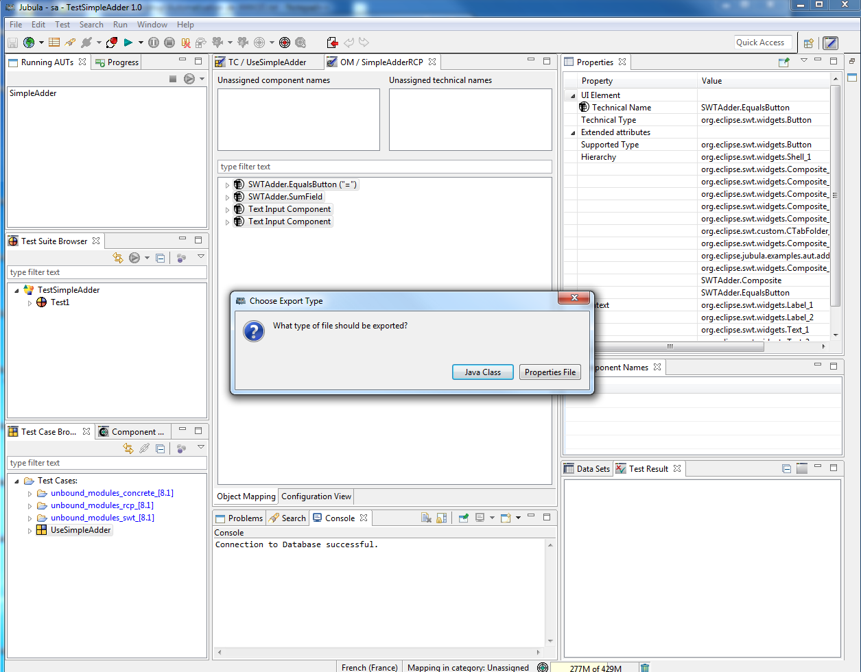

Hello to everyone,
To automate the SimpleAdder application with Jubula, we need to use the loadObjectMapping method. In this method, we use this :
URL input = TestJubula.class.getClassLoader().getResource(
"objectMapping_SimpleAdderRCP.properties"); //$NON-NLS-1$
And I don't find the objectMapping_SimpleAdderRCP.properties file. Does anyone know where I can find this file and what is its utility ?
Here is the website where I found this method.
http://git.eclipse.org/c/jubula/org.eclipse.jubula.core.git/tree/org.eclipse.jubula.qa.api.rcp/src/main/java/org/eclipse/jubula/qa/api/TestSimpleAdderRCPAUT.java
I use the version 8.1.3.033 of Jubula.
Best regards.
Romain.
[Updated on: Mon, 18 May 2015 04:25] by Moderator
Re: loadObjectMapping() method [message #1695809 is a reply to message #1695625] Tue, 19 May 2015 09:02 Go to previous messageGo to next message
Finally, I found the way to create the objectMapping_SimpleAdderRCP.properties file.
So, I launched Jubula (version 8.1.3.033). I used it as usual : Connexion to the agent, Open database, Open Test Case, Launch the application. After this, I started Object Mapping Mode and Jubula gives me the list of the GUI components and their association. There, I select the whole list and right-clic on the selectd items -> USE in API -> Export Object Mapping to File. A window opens and I selected Properties File (there is another choice that is "Java Class"). index.php/fa/21859/0/
And That's all.
Thanks for your time.
Best Regards.
Romain.
[Updated on: Tue, 19 May 2015 09:14] by Moderator
Re: loadObjectMapping() method [message #1696061 is a reply to message #1695809] Thu, 21 May 2015 09:18 Go to previous message
Thanks for posting the solution!
