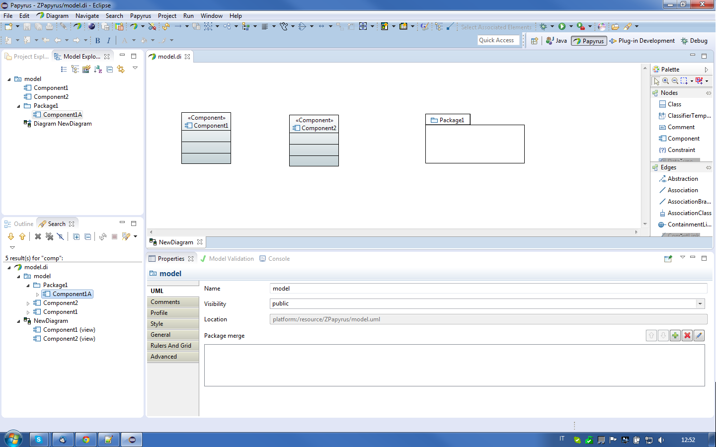

by the way, I can add that while i was doing what i've reported in my first post, I kept open the Papyrus Editor, the Model Explorer View, the Property Tab View and the Search Result View all at the same time.
I've attached a screenshot, I hope it can help.

Nicholas
