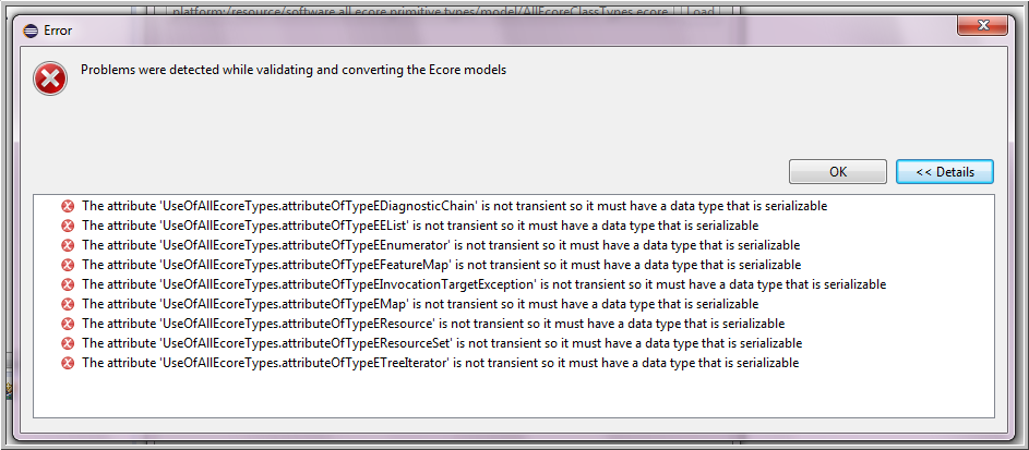

From the EMF book I do understand that I will have to implement the ability to serialize some ECore classes. What I don't understand is how to get GenModel to work and not gives errors on the ECore classes that require manual coding of the serializable interface.

Paul,
So your goal is to create a GenModel despite the fact that the Ecore
model is invalid and you don't want to change the Ecore model to be
valid? Note that as of EMF 2.9 the Sample Ecore Editor supports live
validation (you can enabled it from the menu bar). In any case, you need
to make the data type of those attributes serializable and specialize
the generated XyzFactoryImpl's method for that data type.

Re: GenModel fails on some ECore types [message #1695287 is a reply to message #1695251] Wed, 13 May 2015 07:12 Go to previous messageGo to next message

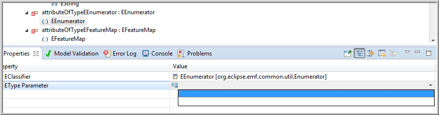

Ed: Thank you for taking the time to answer this newbie's stupid questions. Please hang with me on this. It is my understanding the "serializable" and "Transient" are not the same thing. I don't see a "serializable" property on the nine Ecore types that have errors in the ECore model. Are you saying that all nine must be made "Transient" because "Transient" and "serializable" are locked together somehow in EMF? I know I will have to write the code to make the EClasses "serializable', I expect that. What I don't understand is how to tell the ECore model the attrubute is "serializable" to get past the validation error.
On a side note... Is it possible that because the "ETypeParameter" is unspecified that I have having these issues? The drop down box has nothing for any of the nine attributes in error. See one example below.

Yes, the one is a property on the data type and the other a property on
a structural feature...
Where are you looking? All EDataTypes have this property and it's
generally true bu default unless you've set it to false...
In order to serialize the value of a feature, it must of course be
possible to serialize that value, and so the data type for that value
must be serializeable.
No, you don't have to write such code. Model instances are serialized
reflectively by resource implementations.
You've already told it that, but it's making it clear to you that the
serializer will fail attempting to serialize the values for those
attributes.
No.
I see in your picture that you're using EDataTypes from Ecore. Ones
that are not serializeable. If somehow you want them to be
serializeable (which doesn't make much sense for the ones I see in your
screen capture, you'd need to define your own EDataType wrapper and
define it to be serializeable. If you're a newbie, what you're trying
to do seems a little out of whack. What concretely are you trying to
accomplish?
