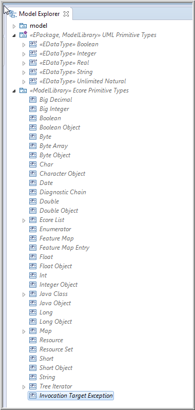

Why is EClass missing from <<ModelLIbrary>>Ecore Primitive Types? Since I am a newbie to the use of Papyrus and Ecore I am thinking my understanding may be wrong. Or maybe a bug, but I have a hard time thinking it is a bug since Papyrus is so mature.

Hi, Paul,
The EClass metaclass is defined in the Ecore Metamodel. It is not a
primitive type, which in Ecore is an EDataType representing a Java type
whose features are not modeled, but rather it is a modeled metaclass,
which in Ecore is an EClass.
So, if you import the Ecore Metamodel, then you'll see EClass,
EDataType, EPackage, EModelElement, and other Ecore eclasses in it.

In UML, EClass is also available as a Stereotype from the Ecore Profile (Extending uml::Class). To type something with an EClass, type it with a uml::Class and stereotype this class with EClass. The Stereotype is useful only if you want to add some specific information which isn't already defined in UML (i.e. ecore-specific properties)
