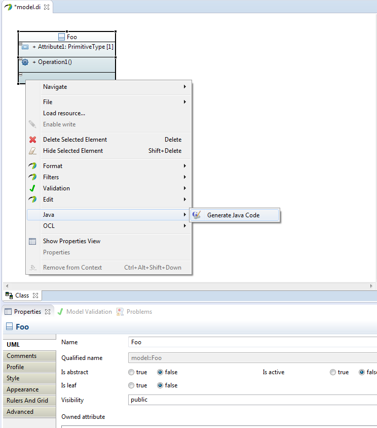

Java Code Generator fails [message #1694925] Sat, 09 May 2015 09:29 Go to next message
Windows 7 SP1
Eclipse 4.4.1
Papyrus 1.0.2.v201504030953
Papyrus Java classes Generator 1.0.2.201504031223
While following the instructions from this https://wiki.eclipse.org/Java_Code_Generation wiki page I get the following error.
index.php/fa/21758/0/
index.php/fa/21759/0/
index.php/fa/21760/0/

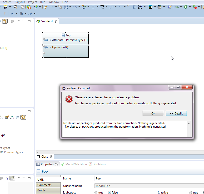

No classes or packages produced from the transformation. Nothing is generated.
  • Attachment: step01.png
    (Size: 110.42KB, Downloaded 2242 times)
  • Attachment: step02.png
    (Size: 44.69KB, Downloaded 2227 times)
  • Attachment: step03.png
    (Size: 69.27KB, Downloaded 2034 times)
Re: Java Code Generator fails [message #1695049 is a reply to message #1694925] Mon, 11 May 2015 11:16 Go to previous messageGo to next message
Paul Roubekas a écrit :
> Windows 7 SP1
> Eclipse 4.4.1
Hi Paul,
Your first snapshot indicates that the plugin is already installed.
This is confirmed by the fact that you have the menu Java->Generate Java
Code.
Unfortunately, the generation doesn't work. Can you check if there is
more errors in Eclipse logs ?
This can happen when the Acceleo Eclipse plugin is not correctly
installed. Can you check if the Eclipse Acceleo plugin is installed ?
Cedric

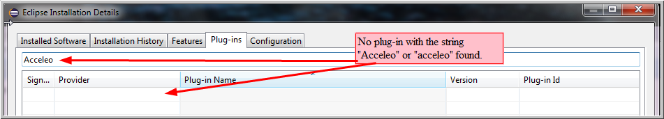

Re: Java Code Generator fails [message #1695056 is a reply to message #1695049] Mon, 11 May 2015 11:54 Go to previous messageGo to next message
Nothing with the string "Acceleo" in my list of plug-ins.
index.php/fa/21772/0/
  • Attachment: Snap1.png
    (Size: 41.49KB, Downloaded 1894 times)
Re: Java Code Generator fails [message #1695149 is a reply to message #1695056] Tue, 12 May 2015 06:02 Go to previous messageGo to next message
Looks like the plugin has not be installed ...
Try to install it (if you have Eclipse Modeling, Help->Install
Modeling Component->Acceleo; otherwise, use Marketplace, search for
Acceleo, select Acceleo 3.5.x).

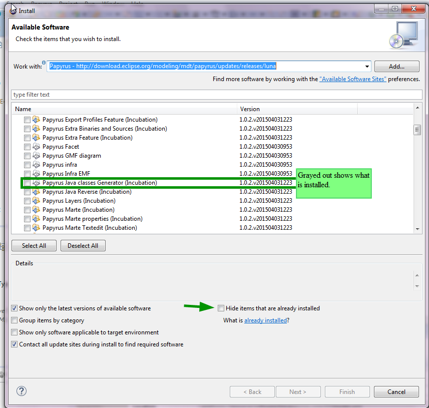

Re: Java Code Generator fails [message #1695160 is a reply to message #1695149] Tue, 12 May 2015 07:43 Go to previous messageGo to next message
This https://wiki.eclipse.org/Java_Code_Generation wiki page says nothing about Acceleo. Should it have been installed automatically with the 'Papyrus Java classes Generator (Incubation)'? If Acceleo is not configured to install automatically with 'Papyrus Java classes Generator (Incubation)' I will update the wiki so other don't have the same issue.
Re: Java Code Generator fails [message #1695161 is a reply to message #1695160] Tue, 12 May 2015 07:58 Go to previous messageGo to next message
Yes, normally it should be installed automatically with the plugin. But
sometime something goes wrong :-(.
If Acceleo is not
Your welcome to help to improve the documentation.
Cedric
