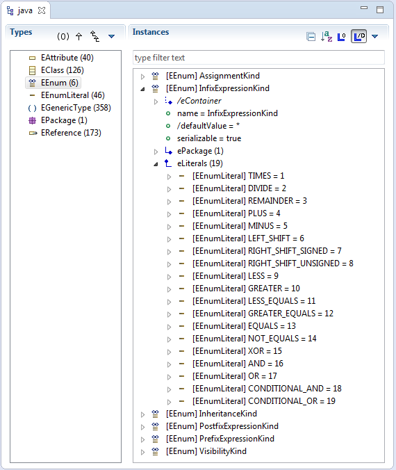

If you are using the MoDisco Java metamodel, then PLUS do is a enum literal from the InfixExpressionKind enum (cf. screenshot below).
index.php/fa/21724/0/
Thus your problem is probably coming from the transformation itself.
