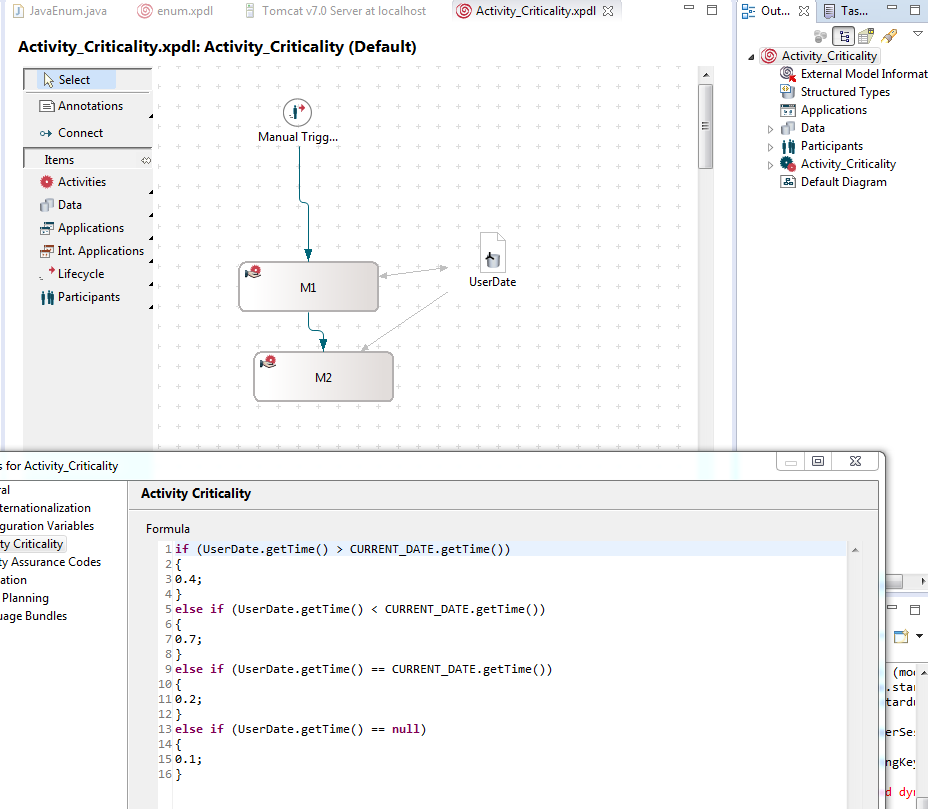

You can use, I mean data(date input) will be available in JS editor. And you can write logic as per your choice. See below screenshot just a sample implementation you can replace with your own logic.
index.php/fa/21694/0/
Check if that helps you
-Thanks

Re: Calculate Criticality based on user input [message #1694122 is a reply to message #1693943] Thu, 30 April 2015 13:39 Go to previous messageGo to next message
Thank you for your response. And you think this could be specific per activity and per workflow? I'll give you and example, just in case I wan't clear enough.
Say I have 2 instances of the same workflow, each one has 3 activities which all 3 have different due dates that are based on the date input by the user, therefore the criticality calculation changes from one activity to another.
Re: Calculate Criticality based on user input [message #1694263 is a reply to message #1694122] Mon, 04 May 2015 02:01 Go to previous message
Yes it should work.
