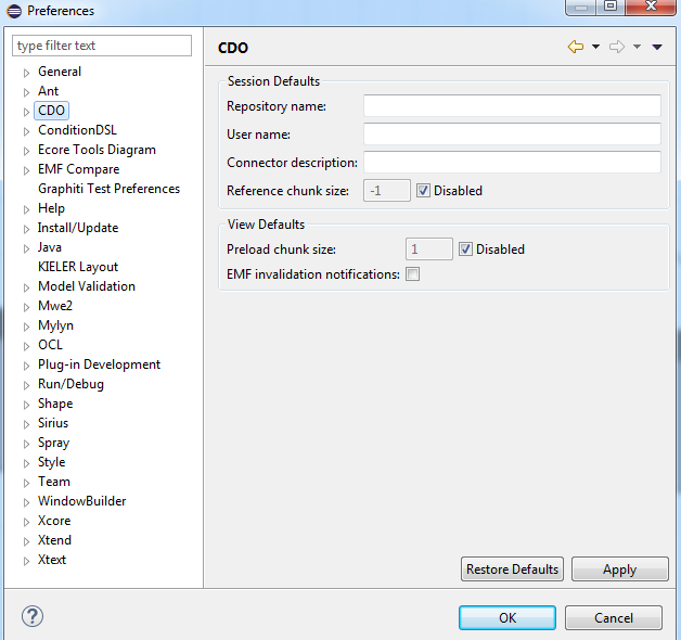

I'd like to know (if it possible with a small example) how to access the CDO preference page (as attached).
In other words, I'd like to know how to get the id, and the keys for those entries.

The majority of the CDO UI will change in the next release (Mars). I recommend to not use these internal preferences.
Most of them will be removed. Nevertheless you can see how it currently works in
org.eclipse.emf.cdo.internal.ui.preferences.CDOPreferencePage.
