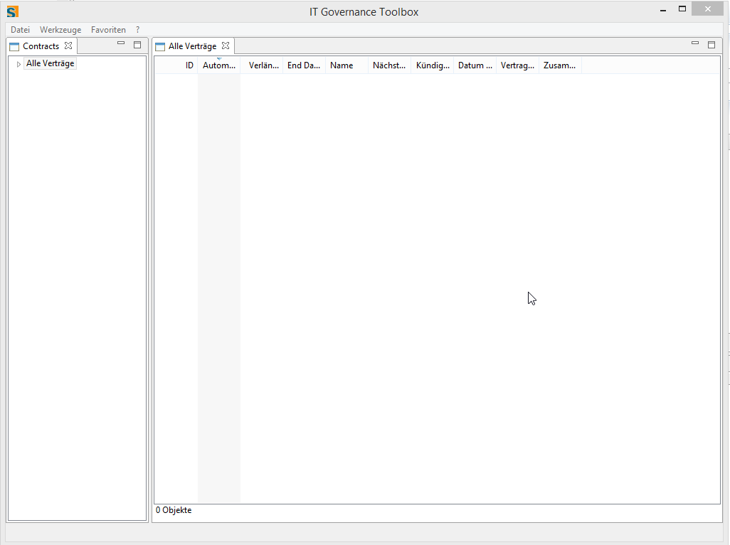

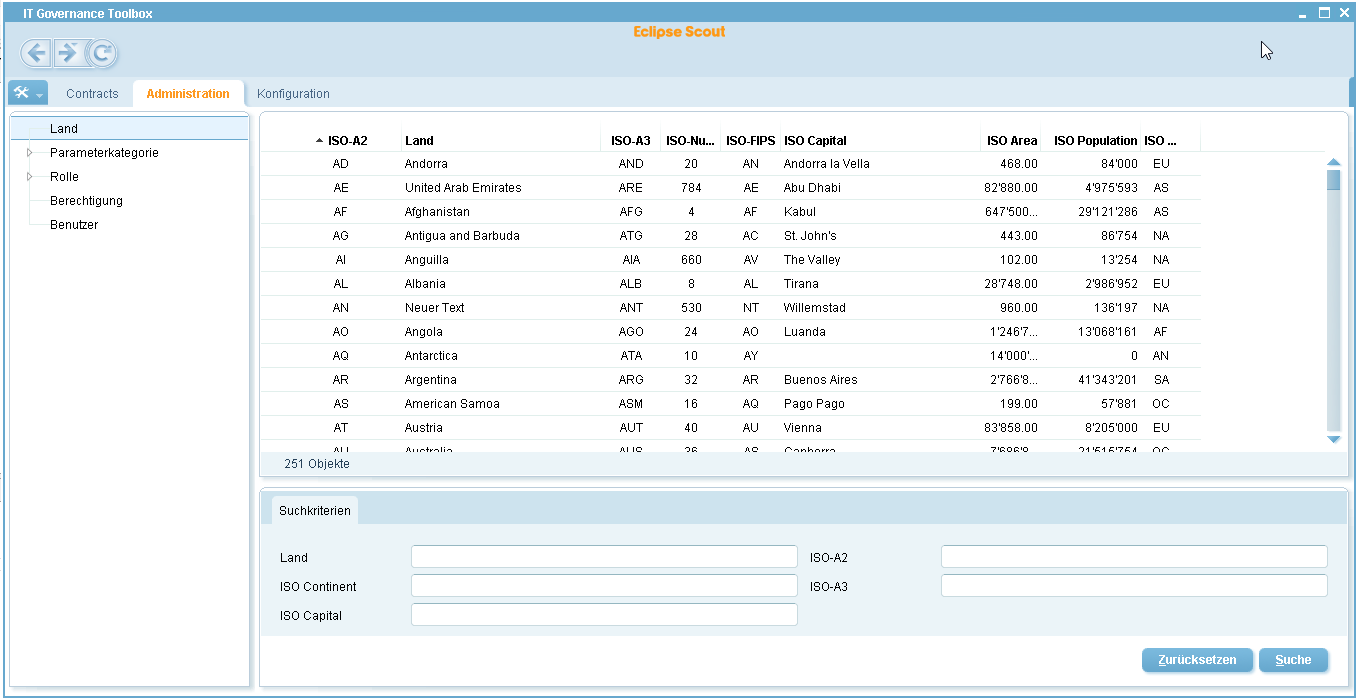

In addition to the "Standard" outline (which I disabled) I created first "Administration" then "Contracts" then (for test purposes) "Configuration".
In the RAP and Swing client I see all enabled outlines.
In the SWT client only the "Contracts" outline.

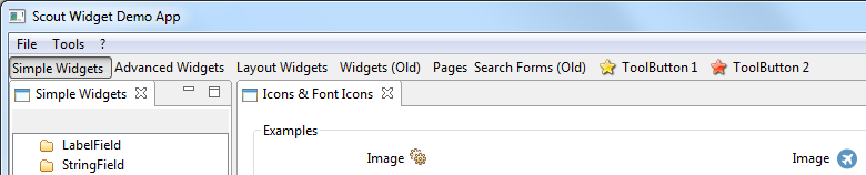

Yes this is a known issue: for the SWT UI, you need to decide manually if you want to display the coolbar in or not.
Here an example of the Widgets demo application (Swt UI):
index.php/fa/21587/0/
To get there you need to open:
<your app>.ui.swt.application.ApplicationWorkbenchWindowAdvisor
In the method:
preWindowOpen() change the value of the boolean in setShowCoolBar(..). It is false per default, you need to set it to true.
