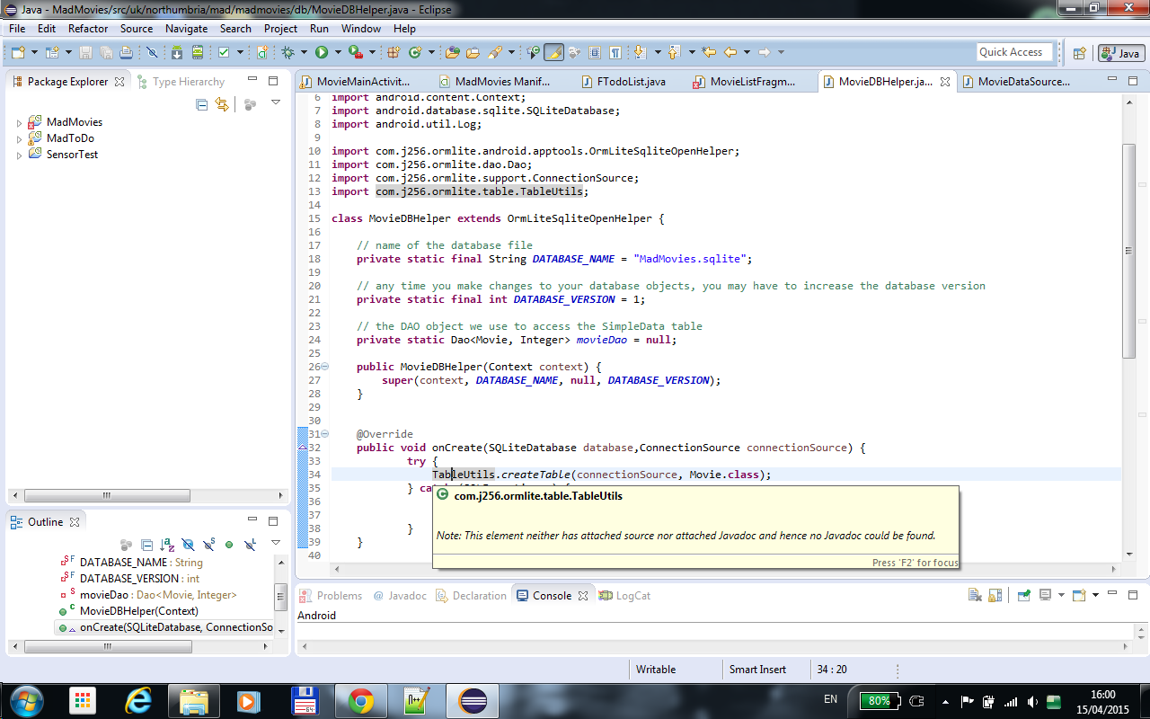

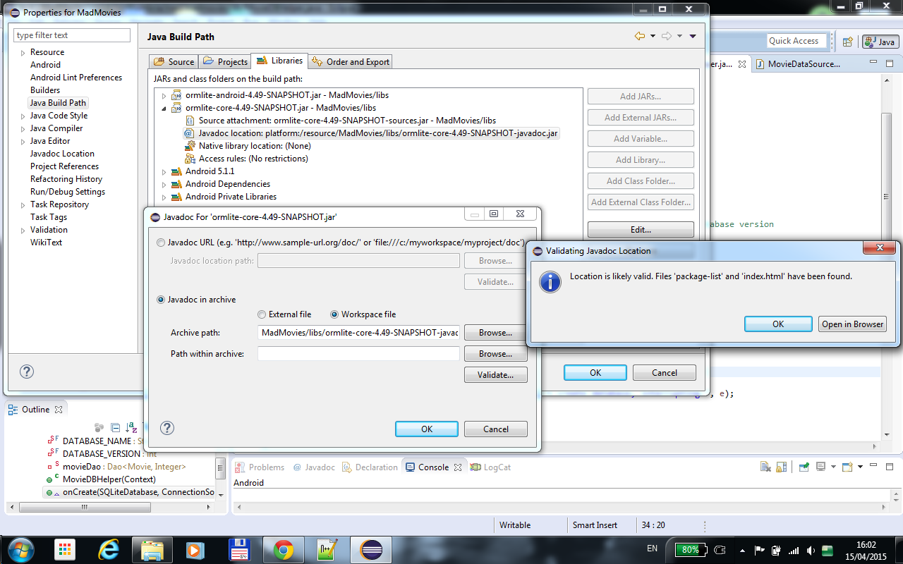

Hi, I have a problem with opening Javadoc of JAR library. Even though it has been linked, verified, and can be opened in a browser from the verifier, it simply does not show up in the code editor.
Please check the screenshots, any help will be highly appreciated ;)

I've actually attached both Javadoc and source JARs. As you can see on the screenshot, I downloaded the main jar, sources and Javadoc JARs, added the main JAR and attached the source and Javadoc to it. But it's like they aren't there.. Wink And yes, those are the correct files, from the same repository and same release - please check the first screenshot.
