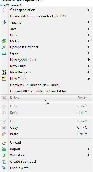

Re: How to remove an imported package? [message #1692308 is a reply to message #1692253] Wed, 15 April 2015 00:19 Go to previous messageGo to next message
Hi Christian!
But, the Delete menu item is disabled? And Delete from keyboard doesn't work either?
index.php/fa/21545/0/
Eclipse SR1a and SR2.
Tomas
Re: How to remove an imported package? [message #1692388 is a reply to message #1692308] Wed, 15 April 2015 08:35 Go to previous messageGo to next message
Hi, Tomas,
Ah, I see. It looks like the 'Enable Write' action is available, which
suggests that Papyrus thinks the model containing this import is
read-only.
Does the Model Explorer show the element you're trying to delete with a
label having grey italic text? If so, that's a read-only model, which
usually means either that it is a model that is itself imported by
another: Papyrus discourages the editing of imported library models in
the context of the model that imports them, because it's confusing if
the same library model is also accessible by one or more other editors.
HTH,
Christian

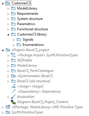

Re: How to remove an imported package? [message #1692396 is a reply to message #1692388] Wed, 15 April 2015 09:10 Go to previous messageGo to next message
Hi Christian!
Hmm, perhaps something is wrong with my imports?
This is my principle setup:
I have a base model (BaseCS) that contains the skeleton parts of a crane related control system.
When a customer orders a crane, he might also want some project specific functions. So, I specialize a CustomerCS from BaseCS, at which point a import the BaseCS model into the customer project model, in order to have access to all the elements that I might need to specialize or reconfigure.
There will be multiple customer projects based on the same BaseCS, thus having the BaseCS model imported and specialized.
Now, in the BaseCS model, I get the following list of... what? Projects that references BaseCS? And some applied profiles also (but I don't get where RobotML comes from, haven't applied that by choice)
index.php/fa/21552/0/
None of these can be deleted though. Now. the following is the contents of my CustomerCS project:
index.php/fa/21553/0/
Is this what is to expect?
But in either case can I remove the imported model, so have I misused this function or what has happened? If so, what is the correct way of doing what I want, because I guess it should be allowed to do this kind of "specialization"?

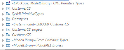

I also tried with a completely empty, fresh project. Delete is disabled, but Unload seems to work.
However, if I import BaseCS I also get a CustomerCS reference as well:
index.php/fa/21554/0/
And, if I try to unload BaseCS, it returns after some 5 seconds. No elements in this model is used is the fresh, clean, empty model.
So, this is weird....?
Tomas

Re: How to remove an imported package? [message #1692459 is a reply to message #1692396] Wed, 15 April 2015 19:56 Go to previous messageGo to next message
Hi, Tomas,
From what I can see of your screenshots, there's nothing wrong.
Any model that is not the "main" model that is opened in the editor
(the one that you double-clicked in the Project Explorer to open) is
treated as read-only in the context of that editor. This is because
they are potentially shared with any number of other open editors that
may also have those referenced models loaded. This includes library
models, profiles, other models in the workspace, anything.
When you import BaseCS into CustomerCS, you probably don't really want
to edit BaseCS in that context because what you're editing is
CustomerCS (and any number of other customer models also use BaseCS).
If you need to edit BaseCS, that is best done in an editor explicitly
opened on BaseCS.
But, if you really want to and are comfortable with the potential
consequences, you can right-click on BaseCS in the Model Explorer and
make it writable. Then you can edit it freely in the CustomerCS editor.
I don't know which of the screenshots is the CustomerCS editor and
which is the BaseCS.
However, it does appear that you may have extraneous cross-references
between resources. CustomerCS even appears twice in one of these. And
I don't know why anything from RobotML would appear. The only reason
why models should appear in the explorer is because they were loaded by
proxy resolution, implying that some model in the interconnected graph
of models has a reference to it, traceable all the way back to the
model that you opened originally in the editor. If you need to seek
and destroy those references, the "Make Writable" context-menu action
should help.
HTH,
Christian
