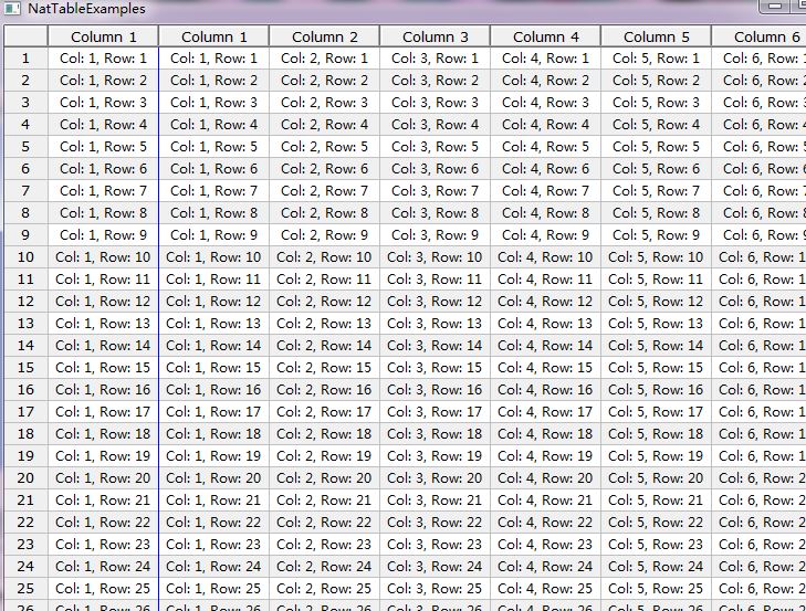

hi, when I set up freeze column as blow code:
freezeLayer.setTopLeftPosition(0, -1);
freezeLayer.setBottomRightPosition(0, 0);
, the data on tale will show one same column. please see the attachements
So how to hide the first column data?
  • Attachment: Freeze.JPG
    (Size: 184.41KB, Downloaded 132 times)

Execute a FreezeColumnCommand instead of directly access the FreezeLayer.

natTable.doCommand(new FreezeColumnCommand(natTable, 1));
But note that this will only work in case the NatTable is rendered because otherwise the dimensions are not yet initialized.
If you need to set an initial freeze state, you might want to register a listener that unregisters automatically after performing the initial freeze:
PaintListener temp = new PaintListener() {
            public void paintControl(PaintEvent e) {
                natTable.removePaintListener(this);
natTable.addPaintListener(temp);
Not sure if I showed a different way in the past. Maybe searching the internet helps too.
