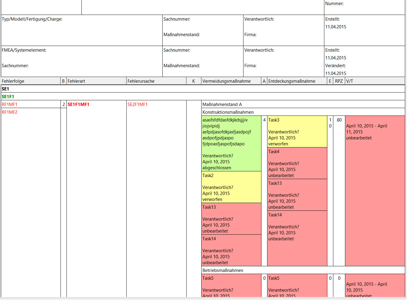

I have a question regarding the possibility to combine two nattables.
This is hte scenario:
I have a complex grid which extensively uses the SpanningDataLayer. The table has a complex header part which has different columns than the rest of the table (it would actually also make use of a SpanningDataLayer). If the columns of the grid are resized, the header should not change. So the idea is to implement the header in an individual table and just display it above the main grid. Ideally the columns of the main grid should be displayed on top of the header table. The header table itself does not need to display column headers. If possible both tables should be displayed in one viewport. So vertical scrolling should also move the header table.
Is it somehow possible to achieve this (or smething close to this) with nattable?
Thanks in advance
Thorsten

Thank you very much for the quick response.
I already tried to use a composite layer with two data layers and a header layer. I think that is what you propose.
I used the VerticalCompositionExample as a starting point, simply created a new data layer with only 2 columns and added it in between the column header and the original data layer.
The second data layer should span the whole table. So I set the layer to percentage resizing. Unfortunately the columns of the original data layer overlapp my second data layer columns.
That is why I thought I need to use two individual tables.
Is the Nattable able to manage this scenario and am I just doing something wrong?
Thanks in advance.
Thorsten

Thanks again for this valuable input. I will have a look into this example. I have attached an image of the kind of table I am trying to reproduce with the nattable. I would very much appreciate if you could have a look at at that image and tell me what approach you would favour in order to model this kind of table with the nattable. The restriction to the table is that hte first three rows should be fixed in layout. So changes in column width of the main table should not be reflected in the header.
Thorsten
  • Attachment: table.jpg
    (Size: 218.32KB, Downloaded 196 times)
Re: How to combine two nattables (so that they appear to be one) [message #1692024 is a reply to message #1692022] Sun, 12 April 2015 06:57 Go to previous messageGo to next message
I really don't understand why you in that case need to have the two tables combined or handled like one. Nevertheless, if those two tables don't have any correlation, I don't see why they need to be connected. There will UX issues arise later regarding resizing and scrolling.
But to answer your question, for me it looks like you need a different composite on top. Maybe a non-scrollable NatTable wrapped in a scrollable composite with non visible scrollbars. And then link the NatTable with that composite on scrolling. Something like that.
Re: How to combine two nattables (so that they appear to be one) [message #1692061 is a reply to message #1692024] Mon, 13 April 2015 02:39 Go to previous message
Putting two nattables on top of each other perfectly suits my needs. Maybe the topic of this thread is a little missleading. There are of course some issues. It would for example be great if the whole structure could be exported to excel as is. Therefor I just wanted to know if the approach to use two tables is the right one or if there are ways to achieve this with one table.
Thanks for sharing your point of view. I have implemented it now with two tables and a vertical scrollbar using a specific IScroller.
Thorsten
