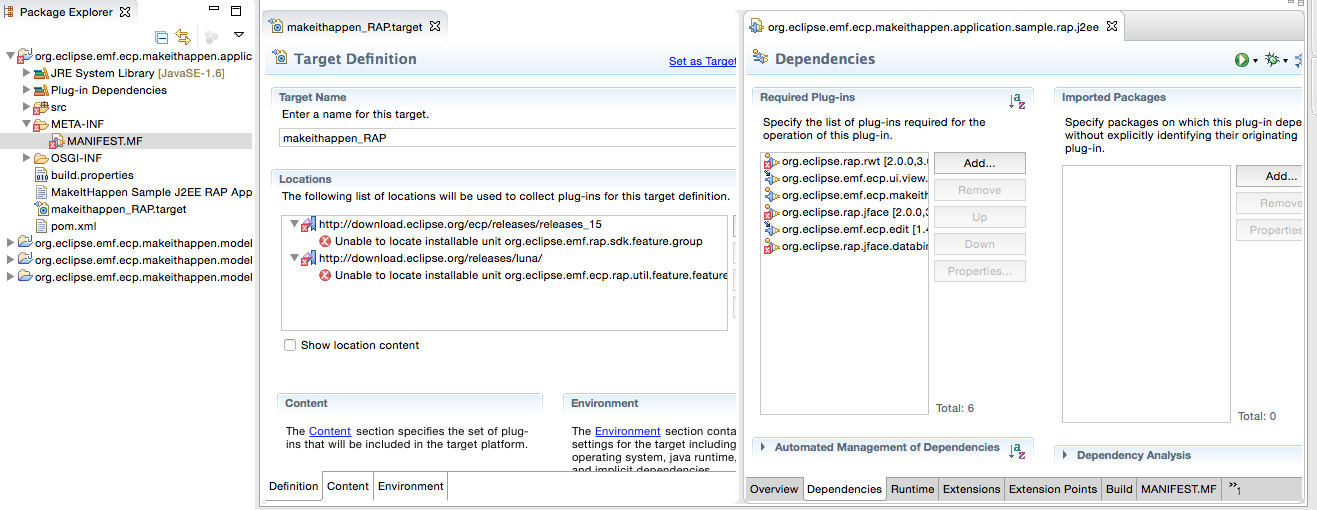

Dear EMF Forms experts,
I had no problem with SWT Renderer and I am trying to make it work with RAP Renderer by following "EMF Forms: Renderer" tutorial.
I started with fresh eclipse modeling package. When I installed sample J2EE RAP application from File -> New -> Example, three plugins are flagged in MANIFEST>MF/Dependencies. Those are:
- org.eclipse.rap.rwt
- org.eclipse.rap.jface
- org.eclipse.rap.jface.databinding
Then I installed RAP tool from Install New Software -> Luna -> Web, XML, Java EE and OSGi Enterprise Development -> RAP Tools, and restarted eclipse. The screen now looks like the following (attached).
It seems I am missing something from your tutorial. May I have your advice on how to make this sample RAP work?
Thank you in advance.
Akira

Hi Akira,
this is a known issue in the 1.5 EMFForms Release.
See here: Bug
I attached a fixed version of the target definition on the bug.
Using it, you should be able to run the example.
Cheers,
Eugen

Hello Eugen,
Thank you very much for your help! Now it works nicely. Smile
Best,
Akira
