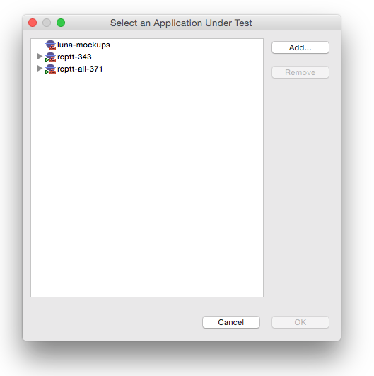

When you start to execute test case RCPTT asks to select AUT
index.php/fa/21516/0/
How to set which AUT Test Case is for you can find here.
