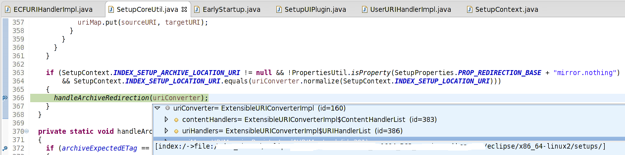

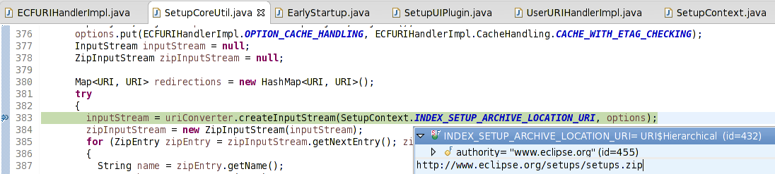

I am not getting how this redirection can be done?
E.g. I used:
-Doomph.redirection.setups=index:/->setups/
Where I created a 'setups' folder in my installation, created the 'org.eclipse.setup' inside it from http://git.eclipse.org/c/oomph/org.eclipse.oomph.git/plain/setups/org.eclipse.setup
But, I am still getting the SocketTimeoutException error.
index.php/fa/26297/0/
It fails when tries to create Input Stream from a http, how to skip this part of code?
index.php/fa/26298/0/

The primary purpose of this is for use the the SetupArchiver application
which builds the zip file containing the entire setup structure (which
is what that code where the exception you're concerned about is
processing). Of course when building this archive, we want to access
all the resources directly, not from the archive itself. If that solves
your problem (I'm not sure why or how), that's fine. But I really
wonder how your application is able to load and index and the product
catalogs...

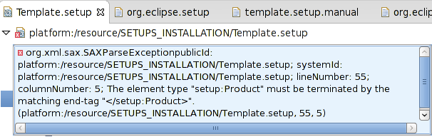

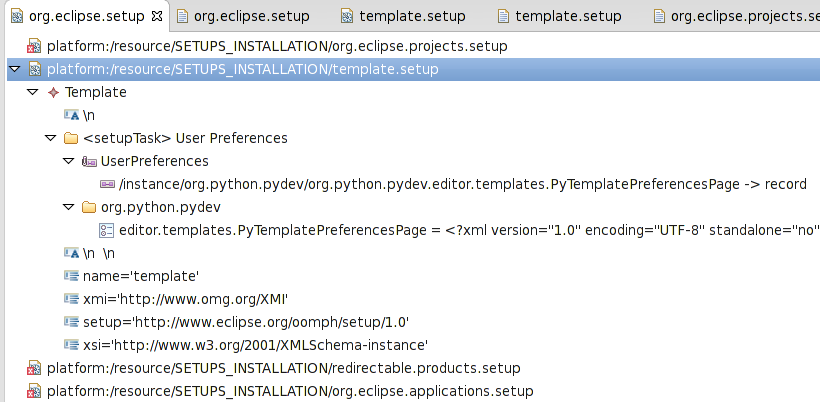

If the above approach is wrong, I am trying to create an index and product definition.
Does it mean that I have to create 'Setup Product Model' ? Seems yes.
index.php/fa/26307/0/
In the created MyProduct.setup file it has some default content, Do I need it? (I don't think so, I can not apply it into the installer based on wiki) I tried to paste the generated content form user.setup. the <setupTask> .... </setupTask>
before last tag.

1. ECLIPSE_HOME/configuration/org.eclipse.oomph.setup did not helped, the preferences is not visible, not applied in eclipse
2. ECLIPSE_HOME/setups - did not helped as well. I have
org.eclipse.setup in this location which is considered by eclipse thanks to
oomph.redirection.setups=index:/->setups/ \
My template.setup is considered and resolved by org.eclipse.setup, but the preference form it is still not loaded.
index.php/fa/26369/0/
How should it be configured in the org.eclipse.setup as Project or Product ?
 <projectCatalog
      href="template.setup#/"/>
or
 <productCatalog
What should I create from bellow? Preference Model, Setup Product model ? for my needs?
index.php/fa/26370/0/
Thank you
Kind Regards
Lidia

No errors so far:
Where I should insert my <SetupTask> ?
I tried few positions but I am getting the error:
index.php/fa/26371/0/
That would be the whole structure that I am getting. What is wrong here?

Lidia,
Use the structured editor (the Setup editor) to edit your instances so
that it's always well-formed XML.
