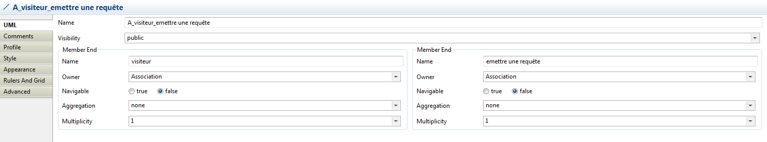

What are the "member ends" objects at each extremity of an association link between an actor and a UseCase ?
What do they represent ?
(I uploaded a picture of the properties of an association link with this message...)

The UML models associations as classifiers that group of two or more
properties that are called its member ends (they are "association
ends"). The association may own these end properties, or the
associated classifiers may own the end properties, or some combination
thereof.
In the particular case of associations between use cases and actors,
the association has to own the ends because use cases and actors cannot
have properties. So, some of the usual controls that you would see for
association ends in, for example, a class diagram are not applicable
here.
This is all just the way UML associations work. There is nothing
specific to Papyrus, here.
