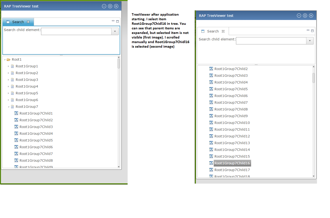

I have a strange problem with vertical scrollbar in TreeViewer.
I created a simple RAP application with two views :
- first with treeviewer
- second with comboviewer
When I create this treeviewer, I select a random element from the tree. Element is selected but scroll is still in top position and selected element is not visible (see attachment 1).
Below code for treeviewer creation:
viewer = new TreeViewer(parent, SWT.MULTI | SWT.H_SCROLL | SWT.V_SCROLL | SWT.BORDER);
viewer.setContentProvider(new TreeContentProvider());
viewer.setLabelProvider(new TreeLabelProvider());
viewer.setInput(UtilContent.getInstance().getElements());
Object root = UtilContent.getInstance().getElements().get(24);
Object group = ((RootElement) root).getChildren().get(45);
Object child = ((GroupElement) group).getChildren().get(70);
viewer.setExpandedElements(new Object[]{root, group, child});
viewer.setSelection(new StructuredSelection(child), true);

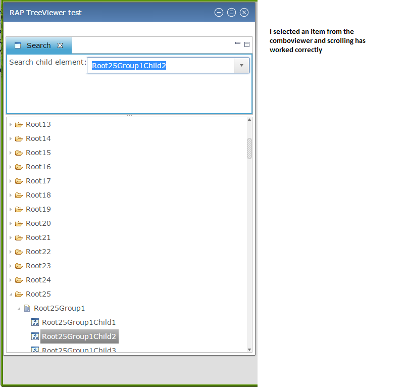

Besides, If I select same element from comboviewer, scrolling works (see attachment 2).
Below code for tree item selection through comboviewer:
comboViewer.addPostSelectionChangedListener(new ISelectionChangedListener() {
			public void selectionChanged(SelectionChangedEvent event) {
				TreeViewer viewer = UtilContent.getInstance().getViewer();
                if (viewer != null) {
                    AbstractChildElement elem = (AbstractChildElement) ((StructuredSelection) event.getSelection()).getFirstElement();
               	    Object[] path = getPath(elem.getName());
                    viewer.setExpandedElements(path);
                    viewer.setSelection(new StructuredSelection(elem), true);
private Object[] getPath(String name) {
		List<Object> path = new ArrayList<>();
		for (Object element : UtilContent.getInstance().getElements()) {
			for (Object groupElem : ((RootElement)element).getChildren()) {
				for (Object childElem : ((GroupElement)groupElem).getChildren()) {
					if (name.equals(((AbstractChildElement)childElem).getName())) {
						path.add(element);
						path.add(groupElem);
						path.add(childElem);
						break;
		return path.toArray();
I use rap 2.3.0. Maybe I do something wrong?
Re: ScrollBar problem in TreeViewer [message #1690830 is a reply to message #1690774] Tue, 31 March 2015 10:05 Go to previous message
it looks like a bug to me. Please file a bugzilla with a small, complete
snippet to reproduce the issue.
Ivan
