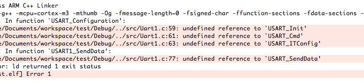

I'm trying to build a program to STM32F0 and the blink_led compiles and work fine in board.
But when I try to do something with the included driver library, like open the serial port, I have some errors:
 21:07:56 **** Incremental Build of configuration Debug for project projeto ****
make all
Building file: ../src/main.c
Invoking: Cross ARM C Compiler
arm-none-eabi-gcc -mcpu=cortex-m0 -mthumb -Og -fmessage-length=0 -fsigned-char -ffunction-sections -fdata-sections -fno-move-loop-invariants -Wall -Wextra  -g3 -DDEBUG -DUSE_FULL_ASSERT -DSTM32F072 -DUSE_STDPERIPH_DRIVER -DHSE_VALUE=48000000 -I"../include" -I"../system/include" -I"../system/include/cmsis" -I"../system/include/stm32f0-stdperiph" -std=gnu11 -MMD -MP -MF"src/main.d" -MT"src/main.o" -c -o "src/main.o" "../src/main.c"
Finished building: ../src/main.c
Building target: projeto.elf
Invoking: Cross ARM C++ Linker
arm-none-eabi-g++ -mcpu=cortex-m0 -mthumb -Og -fmessage-length=0 -fsigned-char -ffunction-sections -fdata-sections -fno-move-loop-invariants -Wall -Wextra  -g3 -T mem.ld -T libs.ld -T sections.ld -nostartfiles -Xlinker --gc-sections -L"../ldscripts" -Wl,-Map,"projeto.map" --specs=nano.specs -o "projeto.elf"  ./system/src/stm32f0-stdperiph/stm32f0xx_gpio.o ./system/src/stm32f0-stdperiph/stm32f0xx_rcc.o  ./system/src/newlib/_cxx.o ./system/src/newlib/_exit.o ./system/src/newlib/_sbrk.o ./system/src/newlib/_startup.o ./system/src/newlib/_syscalls.o ./system/src/newlib/assert.o  ./system/src/diag/Trace.o ./system/src/diag/trace_impl.o  ./system/src/cortexm/_initialize_hardware.o ./system/src/cortexm/_reset_hardware.o ./system/src/cortexm/exception_handlers.o  ./system/src/cmsis/system_stm32f0xx.o ./system/src/cmsis/vectors_stm32f0xx.o  ./src/BlinkLed.o ./src/Timer.o ./src/_write.o ./src/main.o
./src/main.o: In function `main':
/Users/Marcelo/Dropbox/Projetos/Eclipse/projeto/Debug/../src/main.c:115: undefined reference to `USART_Init'
collect2: error: ld returned 1 exit status
make: *** [projeto.elf] Error 1
21:07:56 Build Finished (took 286ms)
But the GUI finde the file.

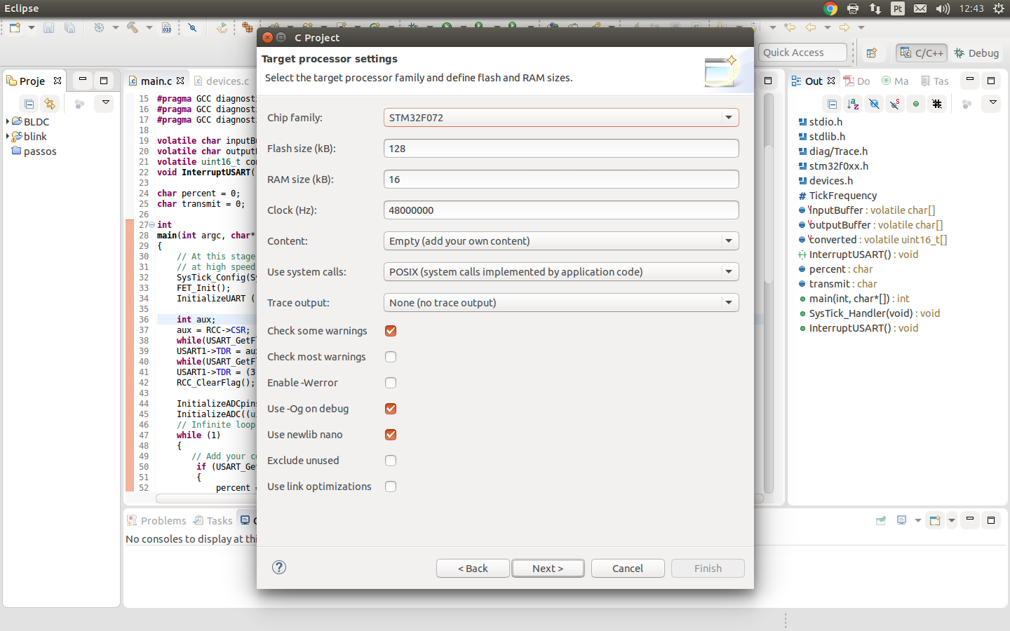

Re: STM32 library undefined reference [message #1712647 is a reply to message #1712284] Tue, 27 October 2015 03:20 Go to previous messageGo to next message
Had the same issue. Solved it by right clicking the file you want to include, say stm32f0xx_usart.c, go to Properties and uncheck the 'Exclude resource from build' box.
Hope this helps!
Re: STM32 library undefined reference [message #1712704 is a reply to message #1690224] Tue, 27 October 2015 10:46 Go to previous message
I created a new project, and uncheck the option: "Exclude Unused" in target processor option... See the picture!
