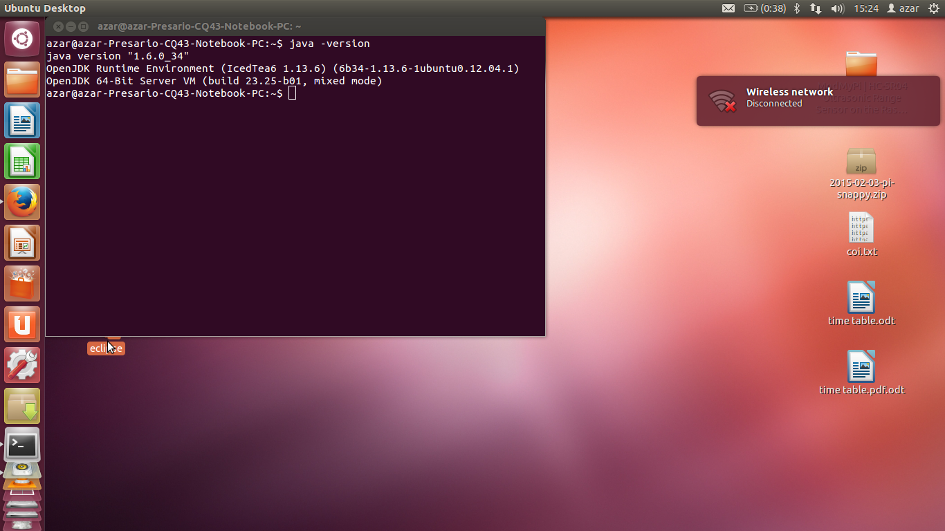

Hi guys, i'm currently working on Running and Debugging MPJ Express with Eclipse for my final project and i'm facing many errores like this one.
Exception in thread "main" java.lang.UnsupportedClassVersionError: runtime/starter/MPJRun : Unsupported major.minor version 51.0
at java.lang.ClassLoader.defineClass1(Native Method)

I am using java version 1.6.0_34

The class was compiled for a newer version of Java: 7. Use that to run it.

Re: ERROR, PLEASE HELP ME. [message #1690082 is a reply to message #1690078] Wed, 25 March 2015 03:36 Go to previous messageGo to next message
Are you sure? What makes you sure? The error makes it clear that's not
the case and your terminal trace makes it clear that your default JRE is
1.6 and that's even what you said: "I am using java version 1.6.0_34".
Now you're claiming you already use Java 7, but certainly you weren't
doing so when you first posted. Did you do something to install 1.7
since then?

It's not a question of running Eclipse with Java 7, you need to have it set up to run your application with it as well. If you were using Java 7 to run your application, you would not see this specific error and message.
From the Installed JREs preference page, make sure a version 7 is present. Then, use the Run->Run Configurations... menu action to open the Launch Configuration Dialog. From there, make sure that that JRE is the one being used for your application, either directly, or with the JavaSE-7 Execution Environment (which will only work if you actually have 7 [or 8]) installed and set up in the preferences.
