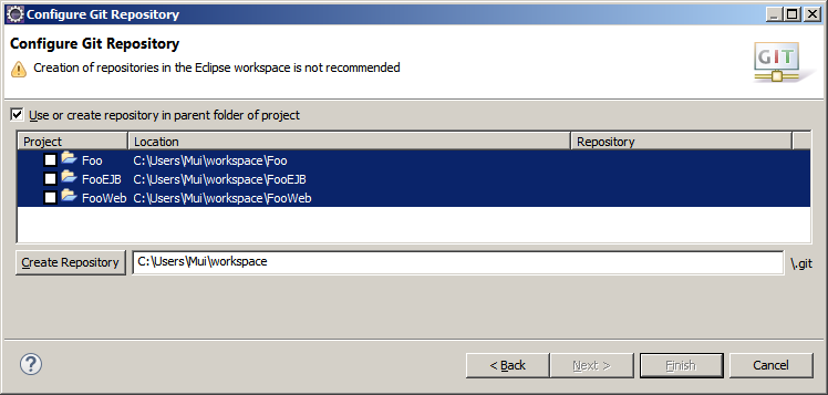

When you selected multiple projects and clicked "Team > Share Project" you have 2 choices:
1. click "Use or create repository in parent folder of project"
- select the projects which should be versioned in this repository
- EGit will automatically determine which folder is the common parent folder containing the selected projects
- click "Create Repository" and "Finish"
- now both projects are now shared with the new repository and you can start committing changes
2. immediately click "Create Repository" and choose the folder where the repository should be created
- this folder can be anywhere on your disk, it will become the root of the working tree of the new repository
- the sharing dialog will now show the current location of all projects and the target path where they will be moved to
when you click finish
- if this looks good, click "Finish"
- EGit will move the projects to these target locations and connect them to the EGit team provider
- now you can start committing changes

I think I messed up a bit my workspace...
I tried starting from scratch:
1 - created three new projects: Foo (ear), FooEJB, FooWeb
2 - select onnly these three projects
3 - team -> share project -> git
index.php/fa/21303/0/
4 - click "create repository", then "Finish"
5 - select again ONLY these 3 projects, "team" -> "commit"
And now here I'm given a list of ALL files of ALL projects in my workspace, even not selected projects.
Is "option 2" the only way to prevent this, by moving the projects in another location? And if I'd prefer not to move the projects...? Am I missing something?
