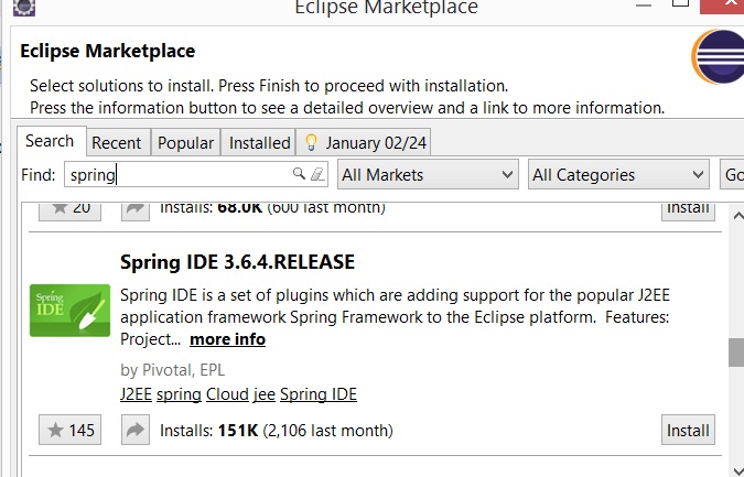

Hi, Sorry if this question has answered before, but I could not find any solutions. I hope you can help me. I have problems installing
After selecting it in the Marketplace, I got this error: " the following solutions are not available: Spring IDE 3.6.4.RELEASE. Proceed with the installation anyways?"...I tried but I can not do it. I looked at Internet for any solutions, without success.​
This is the Eclipse Version that I have:
Eclipse Luna Service RElease 1 (4.4.2)
I attached the screen shots of the error.
Firstly, I select your pluggin from the Eclipse Marketplace,

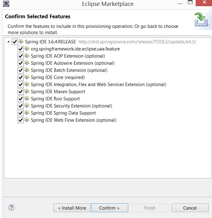

Secondly, I confirmed that I want to installation of Spring IDE plugin.

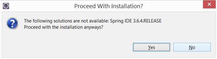

And after that, I got a message that says:
"the following solutions are not available: Spring IDE 3.6.4.RELEASE"

Re: p​roblems installing Spring IDE [message #1689787 is a reply to message #1689574] Tue, 24 March 2015 06:19 Go to previous messageGo to next message
Hi, everyone!
Finally I install The Spring-tool-suite-sts-eclipse-luna-44
and it includes Spring IDE.
It is the only way I found to solve it.
Thanks anyway!
