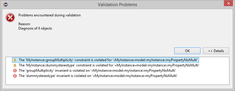

<pre wrap="">UnsupportedOperation is not good.
Sounds a bit like a bug [1] I fixed recently regarding evaluation of user data types, specifically EDate, which is not built-in, and so fell off the end of a list into an UnsupportedOperationException.
Using OCL-&gt;Validate on the UML model in my workspace gives me
<img src="https://www.eclipse.org/forums/index.php?t=getfile&amp;id=21227" alt="">
</pre>
without any obvious sign of any exceptions.<br>
