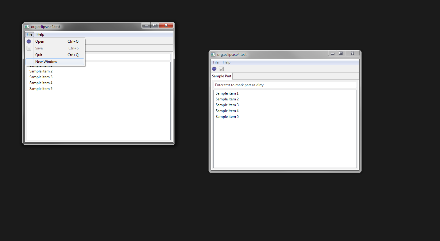

i have a simple e4 RCP application where i want to have a menu item similar to the "Window" > "New Window" option from the Eclipse IDE.
It should open a new "workbench window" containing the same main menu, all parts, handlers, commands, key-bindings, etc. from the already opened window (see screenshot for how it shoud look like).
index.php/fa/21214/0/
