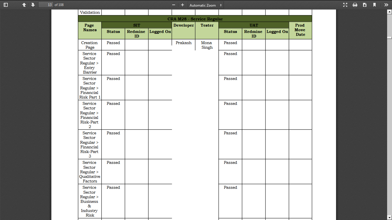

Hi Michael,
I have an issue here in BIRT.
Currently i am using BIRT Report Designer RCP 4.7.0.v201706222054
I am trying to generate a PDF using this BIRT, where there is a blob which is a big HTML Data containing tables, but while generating the PDF the blob looks like this
please help me with this.
Thanks in advance
