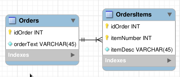

I have two entities working in Master-Detail pattern like this:
index.php/fa/21189/0/
The pattern works as expected with LOCAL RESOURCE, but when i try to move the example to a web environment GlassFish4.1 (JSF) with JTA, i get the following error:

  • Attachment: bd.png
    (Size: 36.69KB, Downloaded 2056 times)
Re: JTA Persistence issue (Null Pointer Exception) [message #1681963 is a reply to message #1677788] Tue, 17 March 2015 10:38 Go to previous message
The problem was in the PK class, change the data type int to Integer and then the error appeared on the method hashCode()
