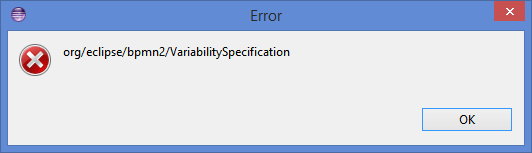

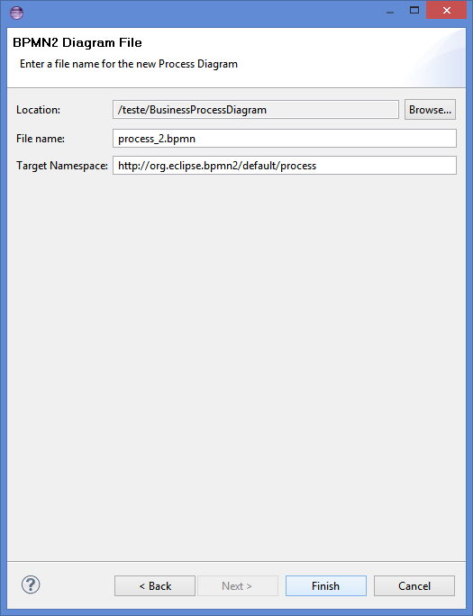

Re: Create the updatesite [message #1689865 is a reply to message #1689850] Tue, 24 March 2015 10:18 Go to previous messageGo to next message
thank you for fast response.
Still giving error (The error happens when I click the "Finish" button to create a new Process Diagram). I added the repository and changed the associate.sites.
I'm running the commands:
"mvn clean install" in the metamodel
and
"mvn clean install -P platform-kepler" in the modeler
Any other command that I have to run?
best regards,
Marcelo

Re: Create the updatesite [message #1689935 is a reply to message #1689865] Tue, 24 March 2015 13:14 Go to previous messageGo to next message
The initial error appears to be related to a new type you've created (VariabilitySpecification) Most likely there's something wrong with your bpmn2 ecore. At least this proves that you are now installing your bpmn2 model instead of the one at eclipse Wink
If possible, can you send me the ecore and I'll take a quick look to see if there's anything obvious. Please feel free to use my email bbrodt@redhat.com if you don't want to share with the entire world.
