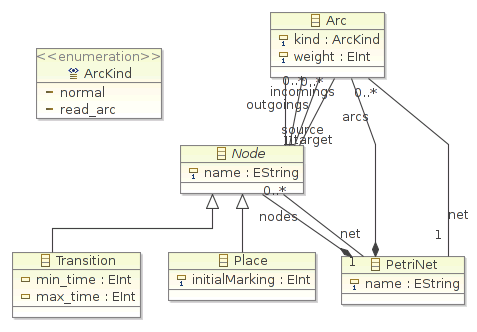

I'm trying to create a Petri-Net Editor with Sirius. My Ecore Diagram looks like this:
See attached file below.
In a Petri-Net edges can only connect Places with Transitions.
I've added an OCL Constraint:
invariant PetriNetConstraint:
self.source.oclType() <> self.target.oclType();
to my Ecore File and it delivers me the right Error after the validation of an example petri net.
Now I need the right Precondition Expression for my Relation Based Edge. How can I formulate in Acceleo or OCL that the Source Type of an Edge can't be the same as the Target Type?
Thanks for your help!
