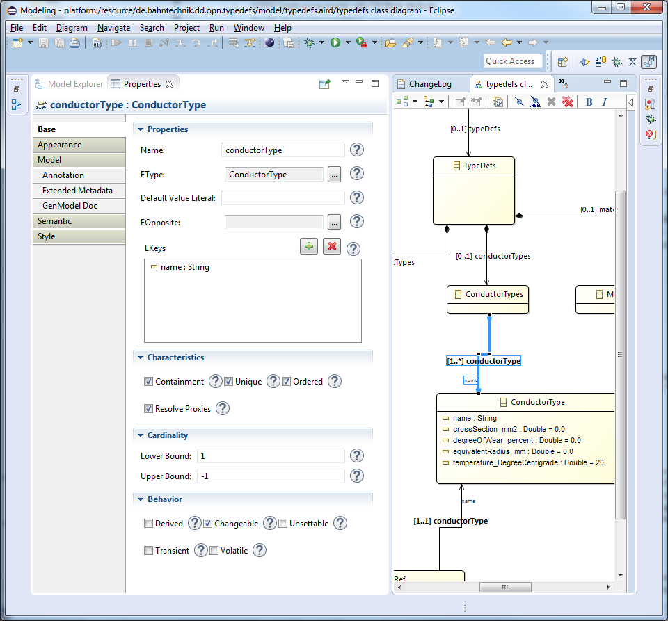

<font face="Helvetica, Arial, sans-serif">Hi Ed,<br>
<br>
thanks for your comments. Live validation is enabled in preference
setting "Model Validation/Constraints". Do I have to sent an
option / annotation to enable validation? See my settings in the
picture below.<br>
<br>
But still its possible to have twice the same key. In my case the
key is a java.lang.String. May be it has some thing to do with the
use of == instead of equals to compare the keys?<br>
<br>
</font><br>
<img src="https://www.eclipse.org/forums/index.php?t=getfile&amp;id=21144" alt=""><br>

Re: EReference and EKeys [message #1668744 is a reply to message #1667734] Thu, 12 March 2015 12:22 Go to previous message
Martin,
Yes, it's a GenModel property (Decorator) in the Editor section which
you can set when you open the *.genmodel.
Yes, in general the model can be in an invalid state with respect to
this constraint. The runtime should be using .equals to compare keys.
On 12/03/2015 7:57 AM, Martin Jacob wrote:
> Hi Ed,
> setting "Model Validation/Constraints". Do I have to sent an option /
> annotation to enable validation? See my settings in the picture below.
> But still its possible to have twice the same key. In my case the key
> is a java.lang.String. May be it has some thing to do with the use of

>> No, it's a constraint that's validated. If you've enabled live
>> validation for the generated editor you'll see that it's checked
>> after the fact...
>>> But the generated default editor is able to set two objects with the
>>> same key into a reference.
>> Imagine changing the value of the key after the fact such that a
>> duplicate arises as a result of that, rather than as a result of
>> adding an object to the reference's list.
