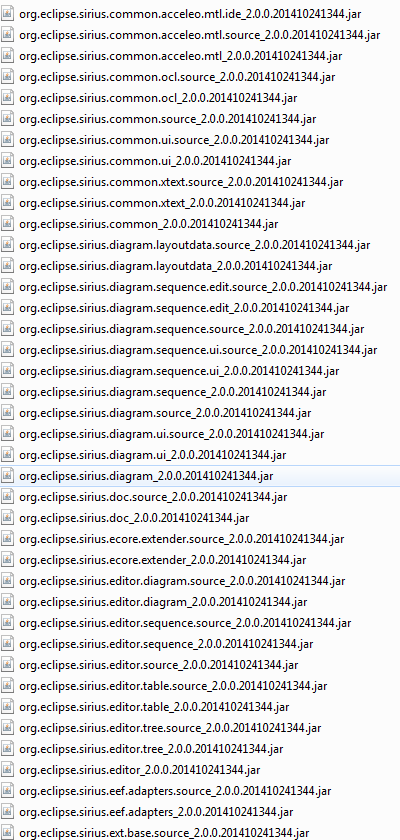

Re: Edge centering problem [message #1677988 is a reply to message #1671113] Sun, 15 March 2015 23:34 Go to previous messageGo to next message
Hi Steve,
The version that I upgraded is 2.0.0. Please see attachment files for more detail.
Thank you very much.
  • Attachment: plugins.PNG
    (Size: 62.99KB, Downloaded 110 times)
  • Attachment: Edge.PNG
    (Size: 19.83KB, Downloaded 127 times)
  • Attachment: EdgeStyle.PNG
    (Size: 16.23KB, Downloaded 111 times)
Re: Edge centering problem [message #1682244 is a reply to message #1677988] Tue, 17 March 2015 13:02 Go to previous message
